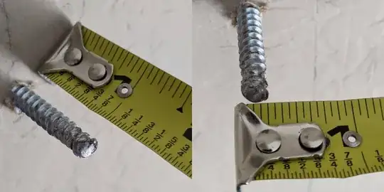

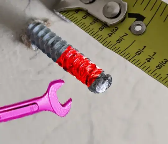

I tried to screw this bolt into a stud to secure a 2x4. The hex head snapped off, and now the bolt is stuck. I managed to slide off the 2x4, but I have no idea how to extract the bolt. IIRC it's a 6" long, 1/4" wide bolt with about 5 inches in the wall.
Looking around on the internet, it seems like I can't get it out without arc welding a new nut onto the bolt. I don't have the equipment or experience to pull that off. Are there any alternative methods that would be more within reach for a novice like myself?
broken bolt in wall showing length and diameter

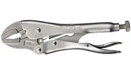

This is a job for vise grips. What I would do is file the bolt flat on two sides. Don't take off so much that you significantly compromise its strength - just flatten the threads. These flat sides will enable you to grip it with a pair of large vise grips. That should provide sufficient leverage to remove the bolt. Take it a bit at a time.
vise grips

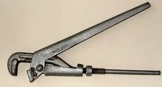

Use a plumber wrench. In general more force and better fit jaws for the task than vise grips:
plumber's wrench]1
Edit upon comment by jay613: Since it's 5" wood. Drill a hole next to the screw, file the screw and then use the wrench. Or save the money by not buying the wrench and go for the answer by jay613 (saw or drill several holes). I also found out that it may be easier to find the original design of the plumber wrench by searching on Swedish wrench.
Edit 2: Minimum damage to the wall may be to drill a hole along the screw and use the wrench. Welding a nut may weaken the screw and it will break again.

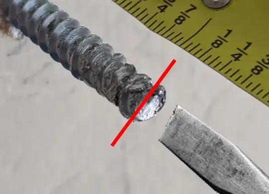

Trick #2 - Cut slot in bolt
Tools needed:
  • Something to cut a slot in the end of the bolt with, for example:
    • A hack saw.
    • A Dremel with a cutting wheel (my preferred tool for this).
    • An angle grinder with a thin cut wheel.
  • Something to unscrew flat slots with:
    • A screwdriver with a nice wide handle for leverage.
    • A drill with a flat screw driver bit.
    • An impact driver with a flat screw driver bit (my preferred tool).
The idea here is to simply cut a slot in the end of the bolt to turn it into something you can unscrew with a screw driving tool:
Use your cutting tool of choice to cut a horizontal slot through the center of the end; wide enough to get whatever screw driver into it. Now you've turned the bolt into a big screw, and you can use your screw driver to remove it.
Pro-tip: If the metal of the bolt is too weak and you find that the areas next to your slot are bending outwards; find a nut that fits the bolt and screw it on after cutting the slot. This will reinforce the metal and you should have no problems (unless you break your screwdriver bit, of course).

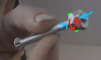

Trick #3 - Cut flats on bolt
This is like trick #2 but for if you have a wrench instead, and you have a way to grind metal flat (you might not have the tools to cut a slot). It's also useful if the bolt (or your screw driver bit) is to small / weak for #2. For this, tools needed:
  • Something to grind a flat on one or two sides of the bolt with, for example:
    • A Dremel with a grinding wheel.
    • An angle grinder with a grinding wheel (my preferred tool for this).
    • A flat file.
    • A solid flat object (e.g. scrap of wood) with some low grid sand paper on it.
  • Something to unscrew a flatted bolt with:
    • A socket wrench (my preferred tool for this).
    • A screwdriver with a socket driver bit and a nice wide handle for leverage.
    • A drill with a socket driver bit.
    • An impact driver with a socket driver bit.
    • A crescent wrench, or some kind of adjustable wrench (not necessarily vice grips).
The idea here is to grind flats in the sides of the bolt (red highlight) so you can grab it with one of your socket tools or wrench, then unscrew it with that:

One option is to use a hacksaw or a rotary tool with a cutting wheel to carve a groove into the end of the bolt, effectively turning it into a flathead screw. You can then use a regular screwdriver to back it out. If the end of the bolt is boogered up too badly, it might help to file it smooth first.
You have 5 inches of screw firmly anchored into a stud so you might need more leverage than a standard screwdriver. A ratcheting socket wrench (or a breaker bar) with a flathead bit would give you significantly more leverage.

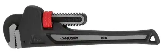

A small (10 inch) pipe wrench should make quick work of this situation. It's designed to literally grab onto smooth round steel tubes.
pipe wrench
