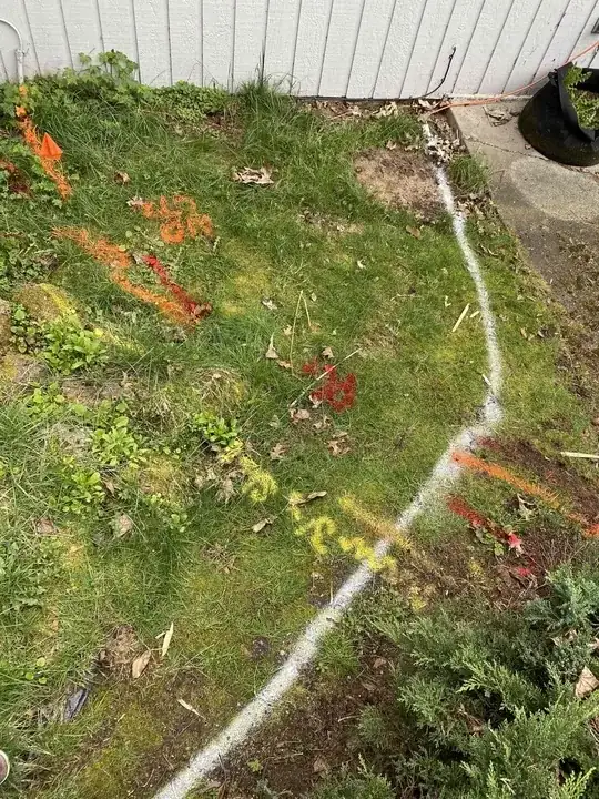

I'm planning on digging a trench for underground electrical conduit. I recently called my state "call before you dig" underground locating service. They finished marking the locations of underground utilities. They all overlap, perpendicular, to my proposed conduit path. Does this matter? Does this mean I have to choose a different path? Or do I need to give a certain amount of space? Or just be careful when digging?
underground utility markings

Crossing existing utilities is no problem; it happens all the time. Just be careful when digging. There is probably a prescribed margin to either side of the marks within which digging must be done with "hand tools only." In some areas the margin is 24 inches to either side (48 inches plus the width of the marks themselves); in other areas it is 18 inches to either side; yet others may choose some other distance.
Even when hand digging a shovel can easily damage the insulation or even cut through direct-buried cable (telephone and CATV are often direct-bury; power might or might not be). Plastic pipes, such as gas pipe or electrical conduit, are much more resilient to impact from a hand-operated shovel.
Soils vary quite a lot. If yours is sandy then hand-digging will be easy. You could even vacuum excavate with the help of a wet-dry "shop vac." Vacuum excavation is considered "hand tools." If your soil is harder, like clay, it's going to be tough going. In this case I'd suggest digging the trench full-depth on both sides of the marks first. You could then make a choice: chip away at the remaining wall of hard soil, or simply bore through it at the height where the new conduit should go. This can be done with running water from a garden hose if the soil isn't too hard, or with a boost from a pressure washer. "Hydro excavation" as this is called is also counted as "hand tools" and is used extensively by professional excavators. Its likelihood of damaging existing buried lines is very low.

You can put your new underground line at that location. Where it may get tough is the depth of the trench: if the existing lines are just at 18 or 24”, depending on your run. If you are using UF you need 24” of cover, if conduit 18” or dig under the existing services.
Be cautious, as I have had markings be over a foot off and the lines be shallower than code requirements, hand dig when getting close.
I usually go under but in several cases this was impractical due to bedrock. When this happened, I switched from pvc to rigid metal conduit and had the metal pipe above the 18” deep utilities (water, gas and communications in the same trench). I have done this several times; in one case I had a new inspector that thought it had to be a code violation, but she signed off on it after over an hour of trying to find a violation (it is ok to change conduit types, if underground it’s not likely to be exposed to power so no grounding is necessary and by definition a 10’ stick of pipe can still be used as a grounding electrode). And in your back yard it can be as shallow as 6”, so it really did meet all requirements.

Some tips here on the types of utilities beneath those marks
Red is usually power, and the power company provides buried wires (not cable) in most cases. It will likely be 2/0 or 1/0 direct bury wire and there should be three of them (two 100+ amp legs and a neutral). Code mandates they be buried 18-24" deep.
Yellow is typically natural gas. Depending on your locale, this could be 18" deep, or it could be as deep as 30" (that's a NY utility). This could be black iron or some other metal.
Orange is often a data utility like cable, phone or fiber. In some cases they have a machine that "stamps" the wire into a shallow trench it carves. Very rarely do I see these deeper than about 6".
Start digging over by the fence for your new line. You'll probably want a hand trowel as you get closer to your lines (even a normal shovel, powered by a foot, can damage these lines to where they need repair). Remember, the lines are approximate and you'll want to expose them so you can dig around them.
