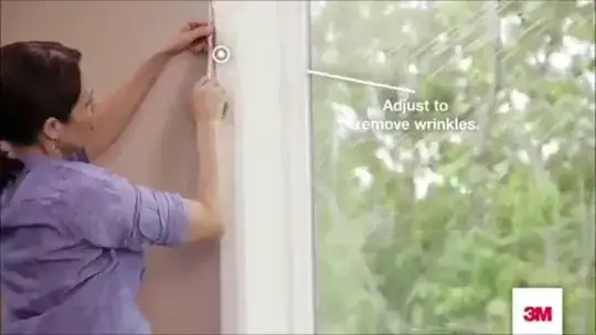

Window insulation film.
window insulation film
https://www.youtube.com/watch?v=gwkmgbzGG-g
This window kit is clear plastic sheeting. You attach it with double sticky tape along all edges. When I did this the last step was to blow hot air on it with a hair dryer which got rid of wrinkles. 3M makes a kit. The plastic must be something like shrink wrap but I dont know if that is essential.
In my old drafty 1930s house I made adhoc extra windows with sheets of plexiglass that I cut to fit the windows. I used foam pipe insulation along the edges and pushed them into place. They worked great but the windows were big and the plexiglas was pretty expensive. I toted those pieces around for some years after moving hoping to find other uses for them.
If I were going to do that stuff again with maximum cheapness I would skip the kit ($$$) get a piece of clear plastic sheet (¢¢¢) and put it up with double sticky tape. Then in spring carefully fold up the plastic for next year.
