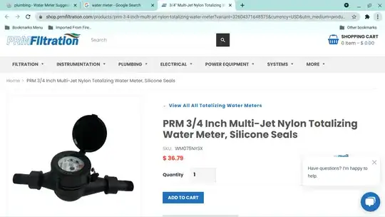

I am installing an underground waterline for irrigation by tapping into the home water line. Since I have well water I don't have a water meter. However, I would like to install a simple but accurate water meter (or similar type device) in the basement before the line exits the house so that I have peace of mind that there isn't a break in the water supply between my house and the garden faucet 160 feet away. Any suggestions?
Thank you!
math314
  • 77
A definite solution to monitoring your line for leaks would be to install a meter.
If you google "water meter", you'll get a list of all different types.
Here is one I found after a quick search:
I'm not endorsing this product and have no affiliation with the company.
