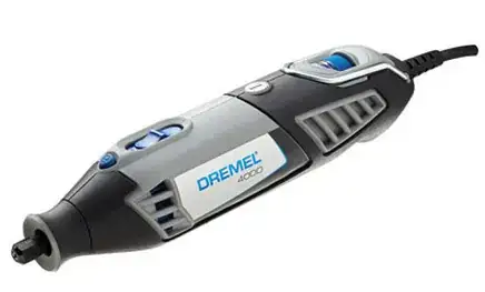

I have successfully removed paint from screw heads and slots by using a rotary tool with a small wire wheel attachment.
