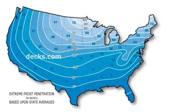

Here's a map of the frost line (depths), and you'll see that Michigan is around 55".
From https://www.decks.com/how-to/articles/deck-footing-frost-depth-map :
Always check with your local building inspections department to see what is required in your area. Furthermore, you must install footings at least 12” below unsettled soil. If you are building into the side of a steep hill or beside a retaining wall you will have to maintain the minimum distance to grade not only vertically but also laterally. In order to achieve a suitable lateral barrier you may need to dig your foundation much deeper than on a flat surface.

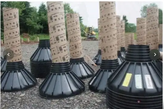

Your typical 12" cylindrical footer will take at least 4 bags of concrete, without having the bottom belled out. Imagine trying to dig a hole for these suckers with a post hole digger:
sonotubes
No thank you.

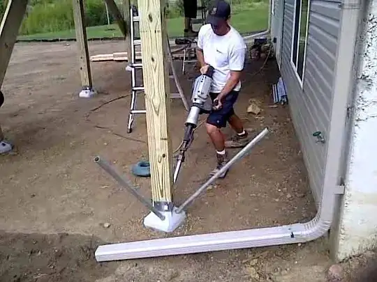

This guy is installing Diamond Piers. He isn't even sweating:
diamond
If you are wondering, there is a good amount of evidence that these don't have issues with frost heave, which you might expect from a shallower footing.

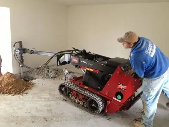

Helical Piers are a third option. They may require some equipment to install, but can also be driven about as deep as you would ever want. They will support almost anything:
helix
heavy equipment is not always necessary. You can probably rent these: helix installer if they don't need to go too deep, you can get away with using a 2x4 for leverage and drive them by hand.
