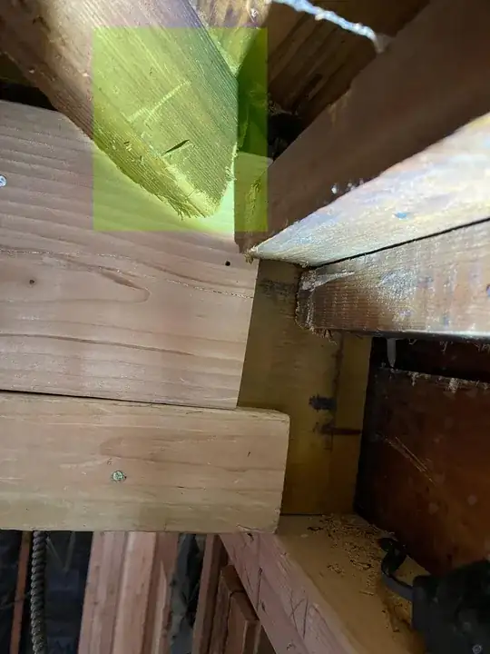

I'm renovating an old house which had a hip roof. One of the roof rafters (2x4) comes down on an angle and isn't supported on the beam. I thought a strong tie lssj would work but the rafter is a bit too high.
What kind of hanger / tie could I use to support the rafter on the beam?
Anagio
  • 121
The ideal is a 3-4' scab with the appropriate hip/valley plumb cut and a 45 miter sistered onto the hip rafter and fastened to the beam.
The reality is that almost anything will do--hips usually don't carry much weight and are almost self-supporting, just as a ridge board often is.
