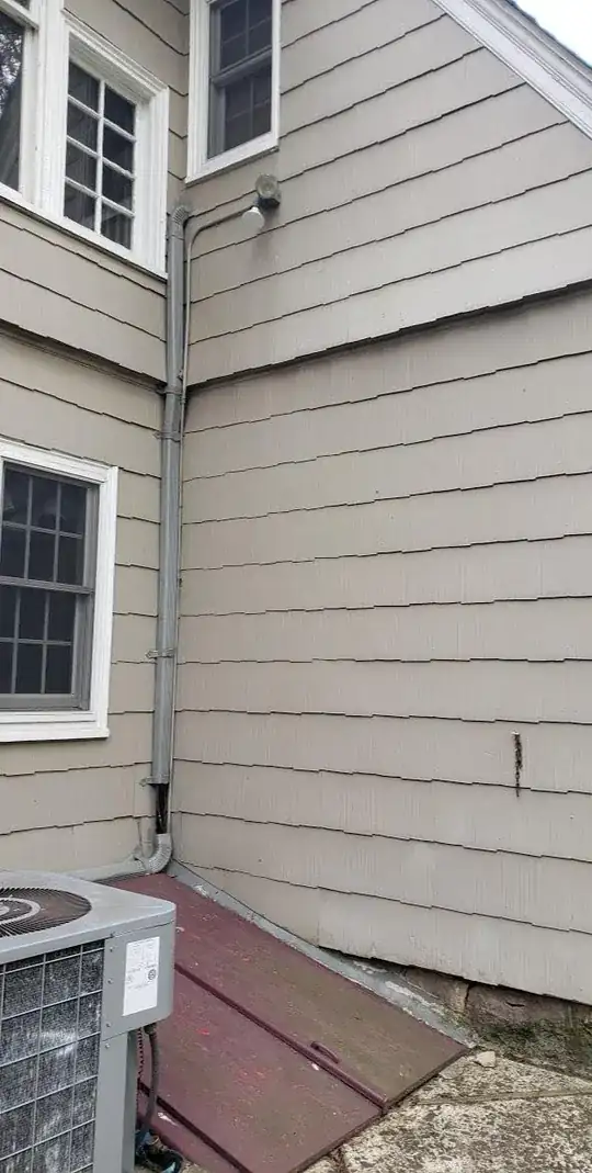

I'm looking for suggestions on how to reach this outside light.
I have a pole to change the bulb but I need to get up there to repair the socket.
  • I have a 14 foot stepladder. To use it over the Bilco door I'd have to build a platform about 3 feet high for two of the legs. Is there a practical and safe way to do that? By practical, I mean, not crazy expensive. 3 feet high would require a wide and strong base.
  • I could rent a 20 foot extension ladder (I don't own one) and place it on the stairs beneath the door, leaning on the wall to the left but then I'd be facing the wrong way while I'm on the ladder.
  • I could build a leveler for the rented ladder using a concrete block, perhaps with some shims underneath, placed on the staircase with the doors open. Then I could lean the ladder on the right hand wall and would be facing the right way. Is there a safe way to do this? Build my own ladder leveler for use with a rented ladder? What length ladder should I rent? It would be resting on a stair that is about 16 feet below the light.
  • I don't think the windows are a good option. The one on the left is fixed, and over 100 years old. I'm not touching it. The one on the right can open but 1) it's boarded up from the inside and behind some shelving and 2) It's about 2 feet above the light. I'd have to remove the shelving, the boarding, and be hanging out the window from my waist. I don't think so.
  • Any better ideas?

If the door, or, more accurately, the framing around the door, is sturdy enough to support weight, I'd build a platform out of plywood & 2x6, then set the ladder on top of that.
  • One 4x8 sheet of 3/4" plywood to be the horizontal platform above the door.
  • Four 2x6 to act as joists underneath it (this span calculator says that 2x6 on 16" centers will span 9 feet). Place one 2x6 at each edge, the other two in the center at 16" centers.
  • Additional 2x4 or 2x6 as necessary to build a frame work (wall) to support the "high" end of the platform (on the ground). Include some diagonal bracing to ensure the wall doesn't rack and collapse under you.
  • One 2x4 at the top end (opposite the temporary "wall") to support the joists and ensure the weight is borne by the Bilco door's framework and that the weight isn't resting solely on the door itself.
  • Place the framework over the door.
  • Place the ladder on the platform, leaning against the wall to the right.
  • If necessary/desired screw down some 2x4 as stops to prevent the ladder legs from sliding backwards. This may be necessary if the ladder angle to the house wall is a bit too steep, which may be unavoidable due to the width of the door/platform.
With the cost of lumber today, this may well run you the $300 you mentioned elsewhere. However, using screws for assembly means you can easily disassemble when you're done and have reasonably reusable lumber for your next project and it's not a totally lost cost.
The span calculator linked above indicates that a 2x4 is good for about a 6' span. Depending on the exact placement necessary to get the ladder under the light, you may only have 6' of the 4x8 over the door and could get away with using 2x4s instead of the 2x6s for your joists. Also, depending on your tolerance of risk, and since the load will be near the end of the span instead of the center, you may decide to stretch the load limit of the 2x4 instead of going with a 2x6. (This would be your decision, I'm not recommending it.)
Since all the weight of you and your ladder & equipment will be borne by the edge of the plywood farthest from the house, and this is a temporary, single use construction, you could offset the two center joists to that edge, maybe putting them at 6" OC. The shorter span should increase the load carrying capacity in that region and may help serve to reduce any bounciness in your plywood. If I were doing that, I'd leave one joist at the other edge, just to help support the plywood and to give something solid under the temporary wall at that edge. I'll leave it to the more engineering skilled to comment whether this would, in fact, still be safe, but for temporary use, I would feel comfortable considering this as an option.
The platform above the door has the benefit of lifting the entire ladder closer to the light fixture, thus, you should be able to use your existing 14' ladder instead of needing to rent/buy a longer one

I love all the creative thinking, especially the climbing harness with lavish promises made to the assitant/witness/person in charge of summoning emergency services help, but..
Rent a longer extension ladder: 24 or 28, even 32 feet if necessary. Stand it on the ground in front of the cellar door. Lean it against the left wall above the fixed-pane window. Adjust those two points until the ladder crosses slightly below the light fixture at a comfortable position, then climb up and work on it.
You can stand with both feet on a rung, lean your left hip against the ladder, and twist your torso to the right to work on the fixture. You might have to adjust the ladder a time or two to get the positioning comfortable, but you can check that while standing on the lowest rung -- the angles and distances are the same all the way up. Personally, I'm most comfortable when working this sort of thing between elbow and shoulder-high relative to my footing and a little more than a forearm's length away.

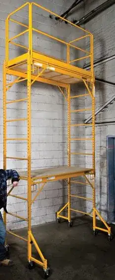

I've discovered something that is growing on me. A rented "Baker Scaffold" with independently adjustable legs. The one pictured can be rented for $70 a day for both levels with guard rails and outriggers. I could only use three outriggers in this location. I'd remove the casters and make wooden shoes to protect the doors from the legs of the scaffold.
Pros: This is by far the safest option and it's cheap. Cons: It will be an entire day's project including fetching and returning the thing.
I'm also thinking of approaches to build a platform for my own ladder. I think I can do it for less than $100. It would also be a whole day's work and less safe. The key to making it cost less is that I do not need an actual 4'x8' platform, I only need strength where the ladder's feet will be. So a large beefy sawhorse made entirely of 2x4s to hold up two feet.
