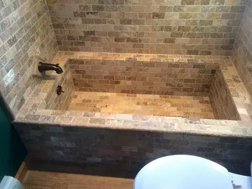

Affordable?
I have no idea. Affordability is relative to the size of your bank account.
Reasonable?
Probably not, they don't seem very comfortable. Do a Google search for "tile tubs" or just see the image below. If you get inspired by the image then make sure to give the outer edge a gentle slope into the tub.
Water-proofing is probably on-par with a fully tiled shower.
I hope you use a dark grout because the base of the tub will be noticeably grungier than the side walls in very short order.
I hope you enjoy cleaning and sealing grout because that will consume a few hours of your life every month.
Watch your step! If you slip and fall then I think the chances of a life-altering injury are markedly higher.
