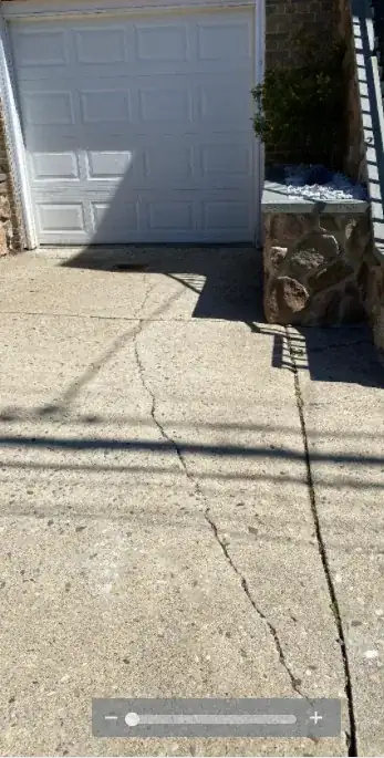

There is a crack on the sidewalk and front of my garage. I want to repair or cover the crack so that everything looks even and uniform.
Any ideas on how to approach this problem? Thanks in advance.

There are really only two solutions from a aesthetic standpoint:
  • Coat the entire slab with a surfacing product (which may or may not conceal the crack for the long term--depends on seasonal/traffic movement)
  • Replace the slab
You can't visually "fix" cracks like that in concrete. The color and texture will never match well, making the situation much more conspicuous than it is now.
Don't try to make it look "even and uniform". Instead, have some intentional decorative feature that camouflages or hides the difference.
For example, rather than repainting the entire driveway after patching the crack, you could paint some fantasy vines on the driveway, where a vine matches the position of the crack.
This is a general idea of a patch or repair includes a visual feature, such as an intentional contrasting stripe, instead of blending exactly. I thought of vines because that's an organic shape; it could be anything.

I have a similar crack in my driveway. The other replies are correct, you're never going to cover it up, but you can make it look better.
My problem was always the weeds would grow in the crack, and make it look much worse. Pulling the weeds out was a chore, and they came back quickly. The solution that worked was a specific (fairly expensive) product called SilkaFlex Self Leveling Sealant.
It's a product that goes in largely as a liquid so it will flow all the way into the crack. After it hardens it remains flexible so it can take the expansion/contraction of concrete, and won't crack again like concrete would. It's also resilient enough that it's lasted for 12+ years of freezing cold, snow, ice, and hot summers. It is NOT cheap, but it's done an excellent job of keeping anything from growing in the crack, and it hides it to some degree. I likely put more than $100 of this stuff into my driveway.
Be advised, you're not going to completely hide the crack, but you can make it less visible, ugly, and stop the weeds from growing in it.
