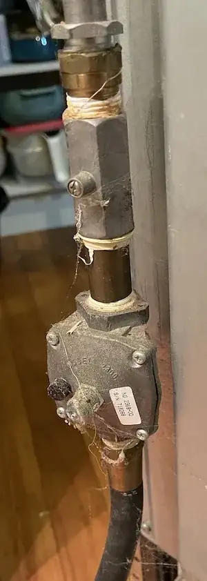

This is the connection on the floor to the main gas supply:
Gas connection between stove and supply line at the floor
That connection looks like it can be twisted and disconnected without issue, so thats my likely candidate.

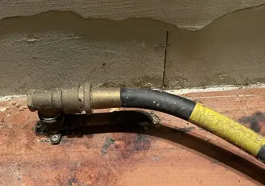

This is the actual connection at the stove, at the other end of that black pipe:
Connection at stove
Nothing there looks easy to disconnect, so I have no likely candidates there.
Am I right in thinking the safety valve is the one in the first picture at the main supply connection?

With a little more research and a better photo of the floor connection, it turns out that the floor connection had the mark “BS669”, which means its a bayoneted valve that auto-seals on disconnection.
Took a deep breath, disconnected it and ... Im still here with no uncontrolled gas release. Valve did its job.
