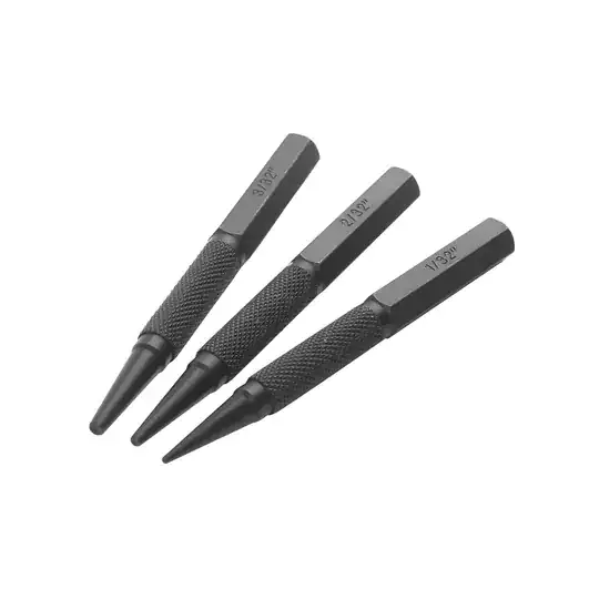

If you don't know the answer then the answer is no. Hammering in finishing nails and using a punch - shown below - is a skill. First you have to get the finishing nail hammered in the right direction, precisely. Then once you get close to even with the wood you have to use a punch to embed it.
On a carpentry skill range this is a solid 8 out of 10 in difficulty and unless you feel you are already a pretty skilled carpenter this is not a skill you should practice developing.

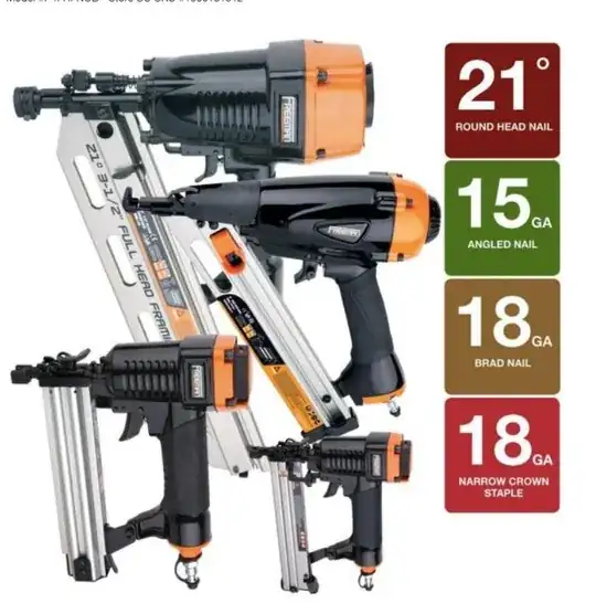

Given that space is not an issue every homeowner that is going to venture into their own repairs is best to buy a nail/stapler combo kit and a compressor. There are just so many uses that it pays for itself quickly and saves you loads of time.
Here is an example... not a recommendation at all. The basics that any home owner needs is a framing nailer, a brad nailer and a stapler. As long as your kit includes those that is a good start. Some kits may include more than one size stapler, some may include air attachments, and some may include two sizes of brad nailers.
This kit was $230. You can get other kits like this with more or less things in the $180-300 range. You get a 5+ gallon compressor for ~$100 and you are good to go. You can go electric but these have more problems and are way more costly individually. Also the compressor has a TON of uses around the house from blowing up tires to painting to floor jacks.
Framing nailer = framing walls, building big things
Brad nailer = trim/molding
Stapler = repairing furniture, securing thin wood panels, crafts
