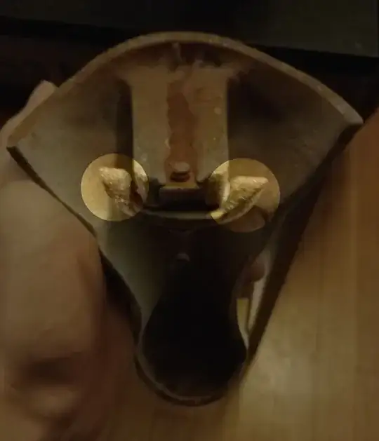

I had a cast iron claw foot tub moved out of a bathroom to remove the carpet floor. The new subfloor and flooring has now been installed. I've moved the tub back into bathroom but in the process of tightening the bolts for the claw feet one of them snapped and I've managed to loose one of the square nuts.
The legs look like the following picture except that the leg retainer highlighted is still attached to the tub. The square nut shown is the one I am missing. Since the square nut is sized to fit the slot it keeps the nut hole centered and allows blind installation of the bolt through the leg to the nut (that is sitting in the retainer). If I have to do this with a standard nut I am in for a world of hurt.
I was thinking that I could glue a washer larger than the slot to a standard nut and angle grind the washer to fit the slot such that the hole is aligned.
The tub currently has two legs installed but the bathroom is small so it is difficult for multiple people to work in the bathroom. The tub is also quite heavy. I was thinking maybe make some cribbing 9" tall (slightly taller than the legs) so the tub is supported while I work on attaching the legs maybe use a car jack to lift it up to install the cribbing. I can as an individual lift the tub up and push something under it.
Anyone do this before?
Any better ideas?
