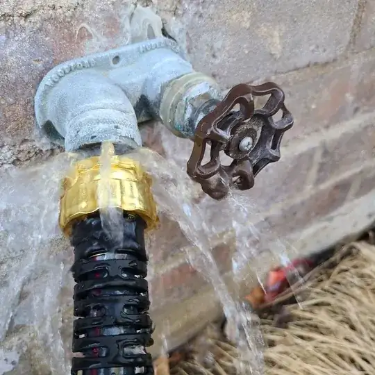

I have a Woodford model 25 exterior faucet bib "freeze less"
When I turn it on, it appears water is gushing out of some holes near where the hose connects, and not much pressure is going to the hose.
What are those holes, suggestions for fixing it?

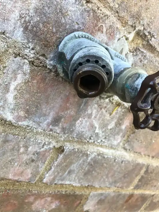

Those holes are probably part of the now required anti-backflow feature. There are rubber seals inside that must be replaced.
Shut off the water at the valve in the pic and unscrew the cap on the left. There will be parts inside which must be replaced. Looks like a large Allen wrench fits inside. If you don't want to get a special large Allen wrench, one could probably use a pipe wrench or channel locks.
EDIT Before you take it apart be sure that the hose you are connecting to it is threaded on correctly and has its own washer seal in place.
