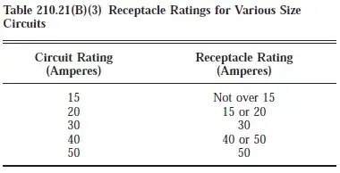

  1. Is it OK to have a 20 Amp receptacle on a circuit with 12 AWG wiring and a 15 Amp breaker?

That won't have any effect. The internals of both 15A and 20A outlets are made of exactly the same stuff.
That's due to a UL requirement that 15A receps must be able to carry 20A internally, so they can be used in 20A circuits per 210.21.
If anything, 20A outlets are a bit worse, because the neutral wiper cannot be ful-width, since it must have a notch in it for the 20A sideways neutral. Of course many 15A receptacles use the same stampings.
Putting a 20A recep on a 15A breaker would defeat the entire purpose of 20A plugs being a different shape. So obviously that has to be a code violation. You don't want to plug a 20A-requiring appliance into a 15A circuit, because it would definitely overload, and ALL safety margin would rest on the breaker tripping.

No 20A receptacle on a 15A circuit allowed.
15A receptacles can safely take a 20A current, so in terms of heat development in the outlet or receptacle, it's the same anyway.

Additionally, 15 Amp services are wired with 14 GA awg wire, while 20 Amp circuits use 12 GA awg.
Make sure your circuits are appropriately wired to carry the required load. Just changing the outlet does not increase the wire Amp capacity.
