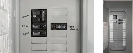

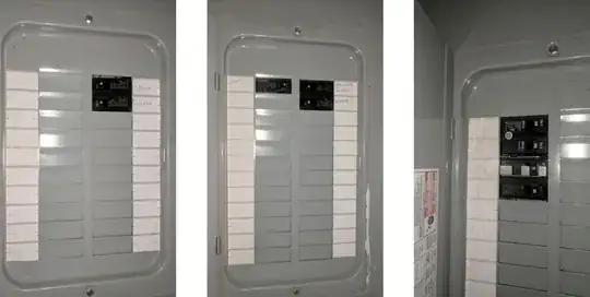

The fire sprinkler rooms get their electricity from building's end-units. There're subpanels in each room. We are told that main panels in the end-units have a "master" breaker controlling the feed into subpanels.
As stated before, variations are wild: from 4 breakers (double-Main, Alarm, Light, Heater) to just 2 (Alarm, Heater).
Some breakers are "fixed" with contraptions, effectively preventing them from tripping! ??
2 3 4 5 6
First question: Does this configuration make sense? I.e. if the main panel's "master" breaker is 20A and subpanel's Double-Main is 100A, what's the point of the 2nd one? Also, this allows the owner of the end-unit to shut off power to the fire sprinkler room. Switching to battery backups should be reported to monitoring company, and will result in somebody showing up to investigate, but still..

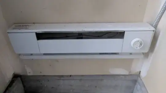

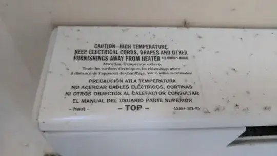

• Haut 42504 303 03 Heater - 1500W.

The 1500W heaters probably relate to the other question's room temperature sensors - there's your heating element to keep things from freezing. And probably most of your operating expense. Or the sensors may just be for alarm purposes, with the heaters on a normal thermostat.
The breakers will trip if they need to. The device on the handle prevents them from being manually turned off. They will trip regardless of the handle position, if they need to trip.
As noted many times in subpanel questions here, the sub-panel main is a local shutoff, and does not need to match the feed breaker supplying the sub-panel. So a 20A feed to a 100A sub-panel main is perfectly legit.
