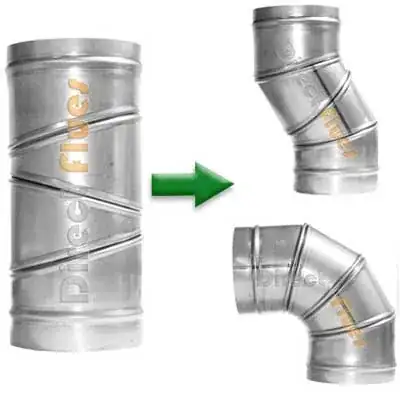

30 inches of height? 3 inches of offset? You need to learn how to use multi-section rigid duct elbows, which can be rotated to be considerably less than the 90 degrees you buy them at. You have plenty of room to make a nice little offset using a pair of elbows rotated to whatever matching degree gets you just the offset you need. You can literally rotate them all the way to straight, so 5, 10, 15 or 27.3 degrees can be easily achieved.
Image from directflues UK - no affiliation
Each section of the elbow can be rotated with respect to the others. Image from directflues UK - no affiliation, but a good illustration (inclusive of the possibility that you could to the offset with one, if it happened to work out that way.)
