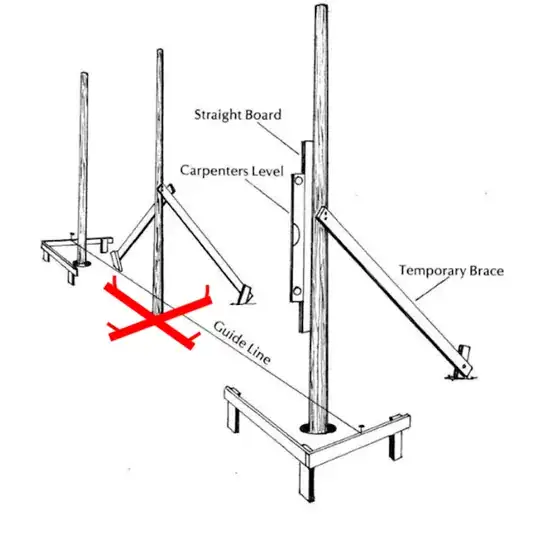

To position the posts plumb (upright), you can support them with braces that are attached near the top of the post, and rest on the ground, with a securing peg.
And to offset the bottom of the post from the bottom of the pit, you can lift them using supports placed flat on the soil (illustrated in red, below).
This allows you to pour the gravel and concrete/cement after adjusting the height of the post and aligning its top with other posts. Or if you are pouring only concrete/cement (no gravel) you can now pour it in one go and ensure that the concrete envelopes the bottom of the post.
You can use this same technique to fine-tune the alignment of the tops of all your posts without having to cut the tops after placement.
You can also pre-cut the posts based on the slope of the ground, and use the offset bracing to do the fine alignment.
Crossing the brace is probably not necessary, since its purpose is to lift the post and not vertically stabilize it. So one 2x4 will do. Also, you can run a long 2x4 from one post to another, resting it on the soil and supporting both posts, if it's hard to brace across a hole due to obstructions like rocks etc..
Original image: https://www.construction53.com/2011/09/setting-and-aligning-the-poles/ with edits in red.
