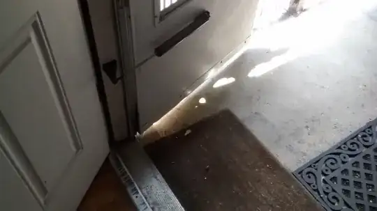

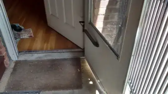

Is there a type of Storm Door closer that allows the door to open over 90 degrees? In a lot of commercial spaces you’ll see those door closers with hinged folding 2 piece arms which allow an almost 180 degree range of motion (note: this is just an example, I’m not looking for anything with that extreme range of motion - just something that will go slightly beyond 90).
Does anything like that exist in a format designed to fit on a typical storm door.

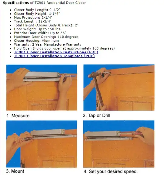

There must be something similar to this (Open > 90 degrees. 110 degrees this model).
enter image description here https://www.doorware.com/site/product.cfm?id=15335

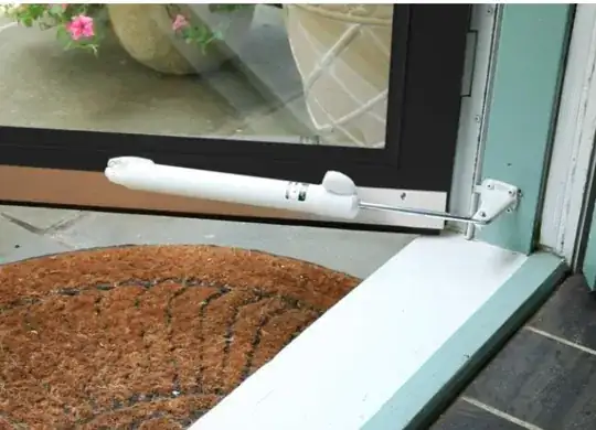

Try this too. Though it indicates open 90 degrees, but actually it may open up further.
Wright Products V150WH Heavy Duty Pneumatic Closer enter image description here
