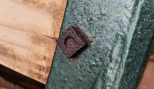

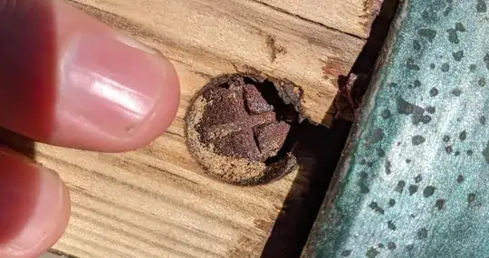

I'm trying to restore an old park bench, and I am struggling to unscrew the bolts. The heads have this wide (~12-14 mm) "flat cross" pattern that I have never seen before (see photo), and I don't have any screwdriver that nearly wide enough to get any kind of grip on them.
My googling attempts to find the right tool have been futile. It might be because I don't know exactly what to search for, but common screwdriver bit sets don't seem to have anything approaching that kind of size.
What would be the right tool to unscrew these and where could I find it?
bolt head
And, for what it's worth, square nuts at the back:
squarebut

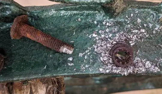

Update:
Drilling successful! One down, 23 to go...
drilled bolt

Looking at the condition of the nut and the minimal profile of the head, I'm afraid the better question may be "how do I get these out with minimal damage to the wood?"
I'd take a drill to the end with the nut. Hold the nut with pliers if the nut-and-screw assembly is prone to spinning. Choose a drill slightly larger than the screw itself. You can either drill all the way through the nut until the remnants of the screw and nut are completely separated, or drill most of the way through and then hammer a punch or nail set into the drilled hole until the screw/nut shears away.

Last resort is to drill either end. It could work out easier to drill the head because its already got a crosshair there, and you theoretically have less metal to drill through.
