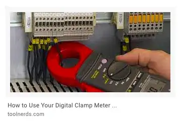

Clamp Power Meter
Buy or borrow a clamp power-meter with a "kWh" feature, that is, the ability to perform an energy measurement.
Not all clamp meters have this, e.g. a "True RMS" meter performs an accurate power measurement for non-sinusoidal signals but still not an energy measurement.
Open the AC unit or the electrical panel (careful, you need to know what you are getting into), and clamp the meter's probe over the live (black) feed of your AC. (If it's a 240V feed there will be black and red, and either is fine, whichever has best access).
Have the meter record the total power over a 24 hour period (more accurately: the total energy), and perform a split A/B test. Test A with sprinkler, and B without and repeat several days. Record the temperature and humidity, and then plot your data, splitting by A/B and sorting it by outside air temperature (e.g. low to high).
Best to perform alternating tests, e.g. in the A/B/A/B order because weather usually changes gradually. Keep the consistent-weather pairs, toss out the outliers like thunderstorm days, cold front days...etc.
I think after 2 days of about the same weather you'll know if there is a difference, and after 10 days you'll be able to somewhat quantify it in terms of money.

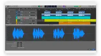

Audio Recording
Alternatively, and this is less reliable, record the sound of your AC for a period of 24 hours. Then in an audio-editing tool estimate how long it is on and off, determining the duty cycle of the fans based on the noise level or recording amplitude (high/low). Place the recording device's microphone near the AC to isolate the fan noise from other noise.
Again perform an A/B split and plot by outside air temperature. If 24hrs is not practical you can try 1 hour around 3pm and 1 hour around 3am and draw a qualitative conclusion, and possibly come up with a quantitative cost impact as well.
Current Transformer
If you are already employing CTs (Current Transformers) to detect the on/off operation of the AC, you could hook it up to a probed energy meter (so no clamp needed) and use it estimate the duty cycle in a split test. It might take effort to translate CT measurements to absolute energy use (kWh by the AC), but if difficult, the split test results could still be useful as a quantified relative comparison between the cases.
Image: https://9to5mac.com/2019/09/15/remove-silence-in-logic-noise/ (but use any tool that plots the amplitude over a wide time span to quickly determine the duty cycle)

Safer than going to the distribution box is to use a true RMS AC current clamp meter such as this: https://www.amazon.com/KAIWEETS-Multimeter-Auto-ranging-Temperature-Capacitance/dp/B07Z398YWF/ together with a current splitter, such as this: https://www.amazon.com/Amprobe-ELS2A-AC-Line-Splitter/dp/B001DPR0FE/
Unfortunately, clamp meters (especially cheap ones as above) tend to be not accurate and may give an unstable reading. The unit above does not have an interface for data collection, either - you should be better off averaging the readings over time.
