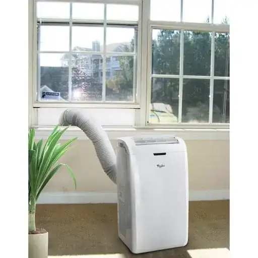

As has already been mentioned, “dual hose” “portable” AC units do exist. So, we need to consider two separate questions: are single-hose ACs bad, and are portable ACs bad?
Single hose operation
For instance, the first point seems to be equally true for any A/C unit, even the ones that have an outdoor unit. The air has to come from somewhere, right?
Yes, but a conventional household window or "split" air conditioner has two independent air flow paths. Air is taken from inside, passed over the evaporator coil, and sent back into the room, colder and dryer. Separately, air is taken from outside, passed over the condenser coil, and sent back outside, warmer. (Or, exactly the same but warm inside and cold outside, for a reversible ("heat pump") system in heating mode.)
A dual-hose portable AC has the same refrigeration apparatus and the same separated air flow paths, but the outside air, inflow and outflow, passes through hoses instead of just grilles on the sides of the unit.
A single-hose portable AC just leaves off the outside air intake hose, so it is taking inside air and blowing it outside carrying heat.
The air that is being sent outside is coming from inside the room. Thus, some conditioned air is being wasted, and replaced with (warmer, wetter) unconditioned air coming in through building leaks and open doors. So, single-hose portable ACs are less efficient. (We can confirm this from the big-picture perspective of thermodynamics, which tells us that any time we take substances of two different temperatures and mix them (here, the cooled air and the leaked-in air), we are discarding the energy that went into creating that temperature difference.)
There's a secondary problem: The negative pressure extends to adjacent rooms (unless you have unusually airtight doors). As a consequence, running a portable AC in one room will tend to make other rooms warmer because they're experiencing the warming effect of pulling in more leaked outside air all over, but not as much the cooling effect of the AC's output (unless you have fans to blow it all around).
Neither of these is a problem in a dual-hose AC — theoretically. (In practice, users have found that some dual-hose units have poor construction such that the "outside air" side of the machine is not very airtight, and thus tends to pull in some inside air.)

I read an opinion somewhere that almost all mobile air-conditioning systems are "working against themselves".
True, because almost all mobile air-conditioning systems are single-hose units. (Why? I don't know. Probably because they are cheaper to make and look less bulky, and only recently did (USA) efficiency ratings start requiring accounting for the inefficiency due to the outside air brought in, if I remember correctly.)
An A/C whose motor and compressor is inside the house as opposed to being mounted on the outer wall is inherently "flawed". I am talking about an A/C with a single outgoing exhaust hose
The inherent flaw is in units with a single hose, but it is possible to have the compressor inside the house with a dual-hose system, which is still less efficient but not “flawed”.
  1. By pumping the hot air out, the A/C creates an under-pressure in the house which sucks in more hot air from outside
True.

All three of the points you cite are indeed true.
The first point is not true of the other common A/C designs (i.e. central air, split unit, window mount). All these types dump the heat into the air outside the house and blow the heated air away. Only the mobile type dumps the heat into the air inside the house and then blows the heated air away.
The only advantage to the mobile type is that it can be used in places where no other type can be installed. If you don't have central air, don't know how to install a split unit, and can't fit a window mount into any of your windows, you may decide that a mobile A/C is better than nothing.
It is just another of life's little imponderable mysteries that there is no such thing as a mobile A/C unit with two hoses, that would draw in outside air to dump the heat into, and not create an under-pressure in the house which sucks in more hot air from outside.

Here is a shorter version of what the issues are regarding a single pipe or vent portable air conditioning unit. Issue 1 is the most important.
Issue 1: Does the exhaust vent (on a single vent unit) suck hot outdoor air back in the building? Yes it absolutely does. The negative effect of this depends on the difference between the indoor and outdoor air temperatures. It also depends on the air flow rate of the exhaust vent. If the outside temperature is 40C, and the temperature in the building is 39C, then the effect of sucking outdoor air in to the building is negligible. If the outside air is 40C, and the indoor air is 30C, then the effect of sucking 40C air in to the building through every crack and unsealed window will have a noticeable negative effect on cooling capacity. As the temperature difference increases, the efficiency and cooling capacity drops. Eventually it will reach a point where no matter how well insulated the building is, the effect of sucking in hot outside air counteracts the cold air coming out of the unit and it becomes impossible to cool the building any further.
It is possible to design a single vent unit to work better by reducing the air flow rate going out the vent pipe, and therefore increase the temperature of the hot side condenser radiator. Increasing the condenser temperature makes the unit less efficient, and it is still sucking in cooled indoor air to blow out the vent, just less.
If you have a single vent unit you can observe the hot air outside coming in to the building by cracking open a window and holding an unfolded napkin or thin tissue paper up to it. The air coming in will blow the paper away. Now turn off the portable unit and try it again.
