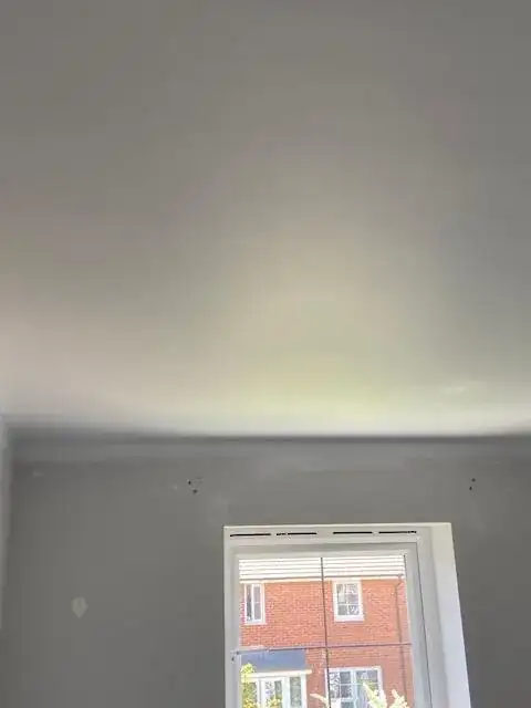

Just inspecting the work today, looks pretty good in most areas apart from one spot...
Fine here

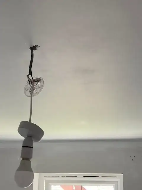

Not so good here
I think I tried to spread the paint too thin in this area, although correct me if I'm wrong.
My question is: can I "touch up" this area using the same roller and paint? if so, how? I don't mind doing another coat of paint but I'm aware that the more coats I do the more of a stipple effect will show on the ceiling. I went the extra effort to sand the whole thing down to reduce this as much as possible and at this rate it's starting to feel pointless!
I painted it using a 9 inch roller, but I have a 4 inch roller and frame of the same brand if that helps (wooster)

Yes, you can re-roll that area. Just use plenty of paint and blend it outward in a radial pattern so you aren't left with hard edges. Matte finish paint is quite forgiving, which is why we use it on ceilings.
I wouldn't sand it. Sanding latex paint can make things worse by tearing up the surface too much. ;
