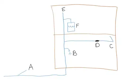

Here is a simplified diagram of some of the pipes in question. Water supply from the street enters from the left.
diagram
  • A: The irrigation system splits off here with an in-ground double-check valve
  • B: Water enters the house here and passes by a shower
  • C: Right angle where the banging occurs
  • D: My patch
  • E: Dead leg before the water heater
  • F: Water heater

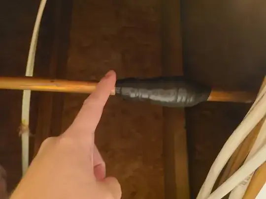

Here's a picture of my patch, with my finger resting on the pipe for scale.
patch

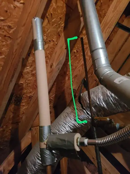

Here's a picture of the dead leg on the cold supply side. Pictured is another dead leg wrapped in insulation for the hot discharge side. This setup is replicated for the water heater on the other side of the house.
dead leg

Why are your dead legs not absorbing the shock. 2 possibilities; 1st the dead leg has filled with water, I have heard of this happening but have not experienced it. Draining the pipe and allowing the dead leg to drain and refill with air.
Second is the new patched section of pipe allows for more movement. Anchoring the pipe alone can reduce or eliminate most water hammer.
I would first take the easy route to drain the dead leg lines and allow them to refill with air , to eliminate the water hammer secure the pipes that are moving.
Between these 2 methods I have rarely seen water hammer be a problem unless the supply sizes and dead leg were undersized.

These dead ended pipes are notorious for swaying when left unstrapped. The patch added a lumped weight which exacerbates the problem.
Rather than moving the pipes, include additional support.
The rapid succession you hear is the pipe resonating from its own weight and elasticity while knocking against wood, and this happens when it is hit by a one shot water hammer from a closing valve. A thick patch adds weight to a specific spot in the pipe, which can increase the severity of the resonance.
