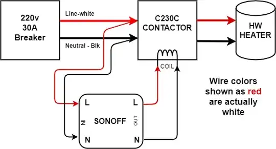

I have an electric water heater in a closet. It is connected to a 240v 30A plug. (2 hots and a ground. NO NEUTRAL!) There is no other electrical circuit available. I would like to put a smart switch in so that I can remotely control it. Most contactors have a low voltage control coil, but I found one that has a 240V coil. The wifi switch is a Sonoff basic which is rated 250V 10A. Is it safe to wire the switch like this:
I would actually be using the 2 hot wires, NOT a neutral or ground like the diagram shows.

Well you can't use a Sonoff because it's not UL listed. But really, I'd say you are making this harder than it is :)
I myself have a 240V contactor switching my water heater, also with a 240V coil, so I could use a common Intermatic run-down timer to control a water heater. However I used a UL listed timer rated for 240V to control the coil, and all the wiring was inside Class I wiring methods (EMT conduit with THHN, actually).
One of the many reasons the cheap Sonoff is not suitable is there really isn't an appropriate/safe way to enclose it in proper Class I wiring methods. After all it needs to communicate via WiFi.
So we'll do an end-run around that problem :)
We'll go back to the more readily available 24-volt coil contactor.
From the 24V coil, we'll run common thermostat wire to a plug-in 24VAC transformer. Transformer makes 24V, picks up contactor, water heater turns on.
"But wait a minute. How is that smart in any way?" Easy. You know how I said a Plug-In transformer? Plug it into any UL listed smart plug from any maker. You command the smart plug to turn on, and the transformer energizes, picks up the contactor, turns on the water heater. And Bob's your uncle!

Do you realize that product is not UL listed?
Here in the US there are those of us that would call this junk from the country of origin.
If it was UL listed and rated to be used with the ground I would say great put it in.
It is not listed and a non listed device could end up with really bad legal issues if someone is injured or killed.
Yes you are only controlling using the hots. Hots are not as bad as a system using the ground that is non listed.
fire could be a possibility with high amperage and junk that has not been listed or certified.
The entire assembly should be encased in a Hoffman box to prevent issues with fire. Not only the sonoff switch but the contactor.

Sonoff BasicR4 devices are ETL listed now. Put all this in a UL listed electrical enclosure and use proper wiring practices, I think it should be fine..
