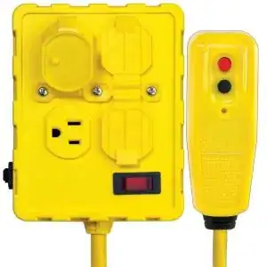

I intend to run an extension cable from an outdoor outlet to power four pond pumps. Currently I have a mess of different wires running across the yard from three places.
The cable runs from the outlet, would be buried 1" underground, run to a 2 ft stake, where it is attached to a power strip, that the pond pumps plug into, something like this:
Enter image description here

The four pumps will require 9.2 amps. Your outdoor outlet has a breaker that's either 15 or a 20 amps so if nothing else is on the circuit, you'll be OK. If you have other stuff plugged into that circuit, you'll have to add up the amps so see if they exceed the 15 or 20 amp breaker.
Now the bad news. The cable and power strips are not allowed to be permanently installed like this or temporarily buried. You would need cable rated for direct burial and it would need to be 18" deep or wire in conduit to a location where you'd need weather proof outlets. The outlets would need to be GFCI protected. This is only a brief summary of what you'd need to do.
Circuits that are GFCI protected at the source, as you intend, require at least 12" of cover, not 1". Unless they are in RMC or IMC conduit and not under a driveway, then 6".
Also, the cable must be of a type fit for direct burial, such as UF-B. It cannot be cordage regardless of the cordage's rating.
The descent to burial depth must be protected by a conduit or other damage shield.
It will need to come up a pole set in the ground such as a 4x4, but you'll already have that. The receptacle can then be installed there.
