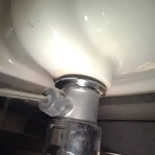

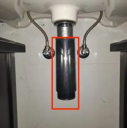

I have a clogged sink in my bathroom. Tried a bunch of things already, like chemicals, a pump plunger - no success. I don't know what's in there but it seems serious.
The next step would be to open the trap and clean it but I have no idea how to open/disassemble it. Pictures below. Any help?

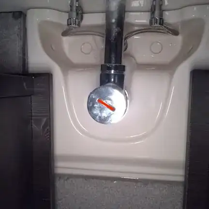

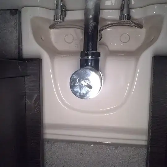

That bottom piece should unscrew by turning it counter clockwise. They usually come with a tool to unscrew it. You can use a steel washer and a pair of pliers or a large screwdriver. You don't want to be laying under it when you unscrew it.... don't ask how I know.

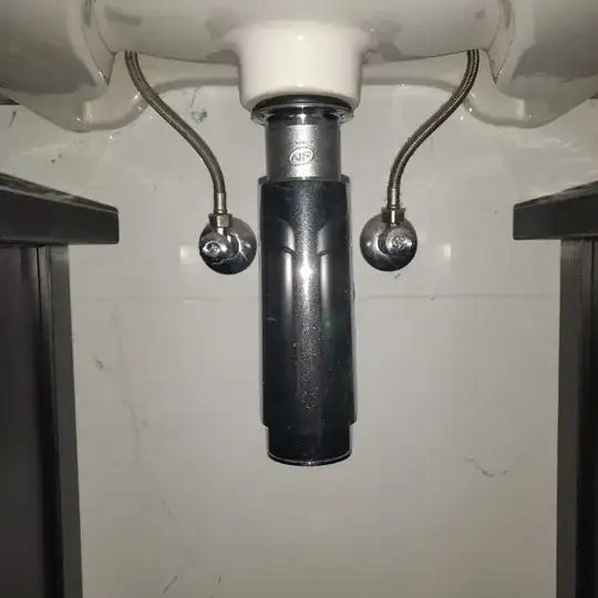

Apparently it is called a bottle trap.
To clean it in-place
Use a large coin to unscrew this part:
Here is a video: https://www.youtube.com/watch?v=x_sUB9PlTw8

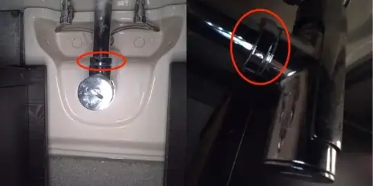

To remove it:

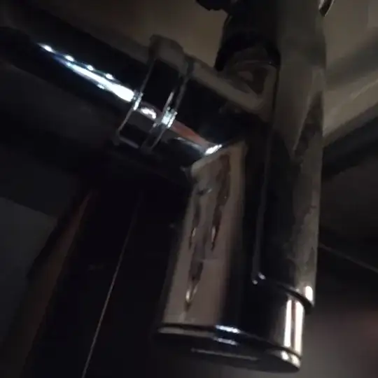

Unscrew this part to remove the connection to the drain:
Then unscrew the entire assembly:
