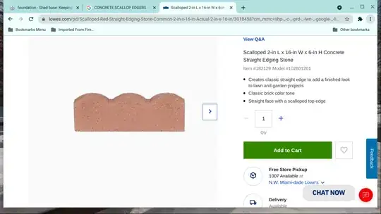

The gravel will definitely be kicked and moved around and will get infested with weeds. Building a border or frame around the perimeter is a great idea but using 4x4's isn't good. Even pressure treated wood will rot in a few years if in contact with the ground. I would think about using some concrete edgers similar to the ones shown below for your frame enter image description here
Then spread some of the weed deterrent landscape fabric inside the frame and pour your gravel on top.

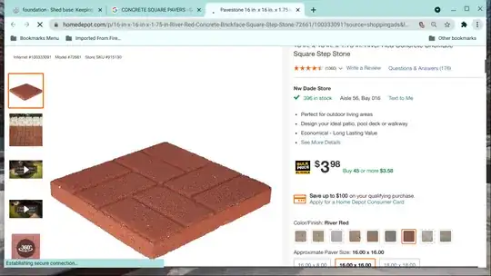

Better yet, instead of gravel, think bout installing square pavers instead of the gravel similar to the ones below. enter image description here
You'd need to prepare the surface better and make it flatter so the pavers would fit in level but you'd end up with a base that would last forever. You could then skip the edgers but the landscape fabric would still be a good idea.
