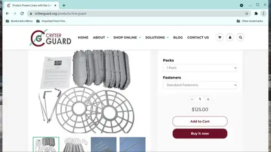

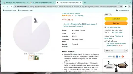

There are many types of animal baffles that can prevent this like the one shown below. You would need the plastic/PVC version and install it where the power company wires attach to your wires. Check with your power company since many will install them at your house or at the pole.
Amazon webpage of Fox Valley brand of squirrel baffles for use on electrical lines
Here's one very similar to the ones we installed, not affiliated in any way
https://www.critterguard.org/products/line-guard
Critterguard webpage for electrical line baffles and spinners
