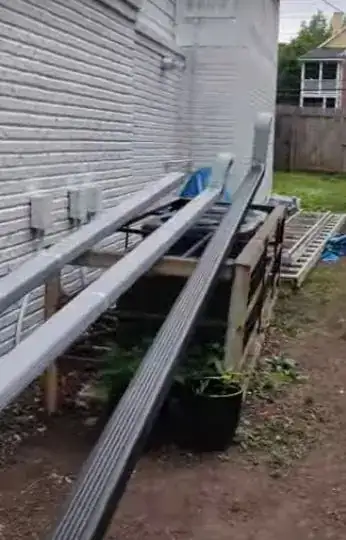

We are trying to make our side yard look aesthetically pleasing. The HVAC compressor cage is an eyesore, as shown in pic below (the gutter were only temporarily removed for painting). What can we do to hide/make it look better?

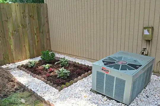

I'm sorry to be so blunt but the A/C isn't making your yard look bad, your yard is making your yard look bad. That wood barricade needs to go!
Search the internet for "landscaping around A/C unit" and you should get plenty of inspiration like the image below:
Source
The main thing to keep in mind is that the unit needs a minimum 2 feet of clearance around all sides so that it is easily serviceable and replaceable when the time comes. A simple rock surround usually does wonders for A/C aesthetic.
If you decide to plant shrubs then just remember that the coil fins will clog with debris often so you'll need it cleaned once or twice per year.

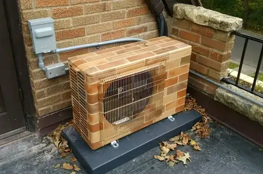

If you truly just despise the look of HVAC compressors then you could camouflage it:

As a HVAC service professional I wouldn't box the condenser with anything, this is problematic in multiple ways. If you want the system to remain problem free you must consider the service it will receive throughout its service life. With that being said, the 2 foot or 18" rule also would not suffice. I would recommend a single fence 4' from the condenser runing along the wall enough to block view. You could use a hedge row but not anything that will grow wild into the unit if left unpruned. In order to get the best service to the condenser you need to make it readily accessible.
