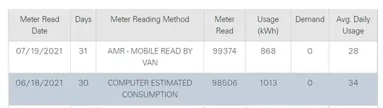

EDIT: Here's a snapshot of the past 2 bills at that hot-weather house, where the AC has been on for both months (newish Trane XR16 on XV 80 furnace/blower). It's ~900 kwH, so somehow less than the cabin. At this home, we have the same cameras, 2 ceiling fans running all the time, older fridge, plus a dehumidifier in the basement and 2x coway air filters, half dozen assorted wall warts.

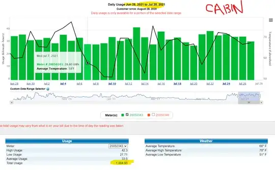

Here's the past 30 days for the cabin. Again, No AC, cooler temps, but more juice used:
Somehow, our electrical use at this northern cabin is the same to slightly higher than at that house in the heat. I'm stunned, because here, there's no AC running at all. (It's broken, and turned off.) While we've been here (right side of chart), the heat hasn't been on either. (Heat is gas, in-floor, so only electrical needed is to run the circulator and exhaust blower.) That's even more surprising to me because this place is really well insulated. Our cooling this summer consists of opening the windows at night to gather up the cold air. Wake up, house is about 65 degrees. Close all the windows, and just keep doors shut, and on an 88 degree day, house is still <74 degrees by evening. (At the Northern Virginia house, if the AC is off b/c of power outage, the house zips to the low 80s in a few hour's time.)

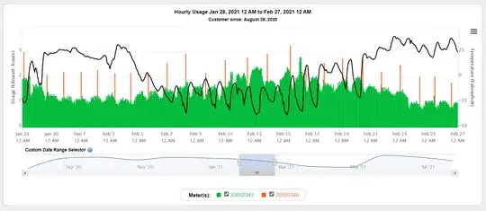

EDIT: Here's a month worth of winter, unoccupied "baseline," which is the circulator running the hydronic (house set at 63 deg), 2 window / box fans pushing that air into far corners, fridge running, security lights, etc. as above. There are electric baseboards set to very low temps in two of the colder rooms where there's plumbing to act as backup against frozen pipes, but AFAIK those never kicked on (no real green spikes). Caretaker said lowest temps he saw in house were ~58 deg. Load kicks up noticeably on the cold days. Orange spikes are water heater (separate meter) kicking on once in a while.

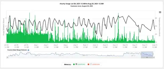

Here's the latest power graph showing that after replacing the septic pump, the use went way down. Somehow, that septic pump was drawing more power even than the new AC unit I had installed a week later.

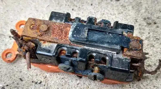

I pulled the tank cover and took a look at the electrical. Yikes. This provided the power to the pump and float switch. (Piggy-back, pump plugged into the float plug.)
enter image description here Obviously, that needed immediate replacement, but it's still inside the riser for now, pending installation of an external pedestal, as should have been done originally.
It was drawing 10 amps, so at 110v, there's the extra kilowatt of constant energy use! With a new, clean outlet, it draws 8 amps when running.
Solution will be a new pump and float switch, new alarm float, new external power pedestal (and a new plastic riser too...)

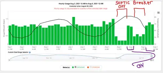

Here's a chart showing (on the right) a few hours of the pump with the breaker entirely off, then back on, then off again, then on overnight. As mentioned, when I jiggled the float with a rake, it shut off, so I thought maybe the power draw problem would be over. Nope, when the breaker's on, it clearly draws all that power again.
Bonus problem, when the breaker's on and there's power to the pump, now I'm not sure it even runs at all, because we went out there, pulled the cover, heard nothing and I pulled the float up to try to get it to run, and it didn't. Tester showed it was getting power, so now I wonder if the pump isn't burned out and just drawing power and converting it to heat like the seized impeller in the hydronic system in the garage last year. (Yeah, the guy who sold me this place was a crook.)
