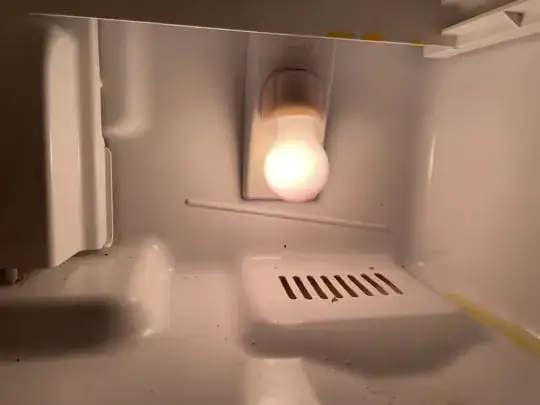

My understanding is that the cold air in the fridge actually comes from the freezer, and that there's a thermostat controlled device that opens/closes that pathway. It appears that these vents are in the back bottom of the fridge, behind the drawers, which would explain why they are so cold. But given that the top isn't very cold, it makes sense that it would keep bringing in cold air, but that cold air all seems to come from the bottom. Here's a picture of the bottom vent that you can see now that I've removed the bottom right veggie drawer.
Vent at the bottom of the fridge behind the veggie drawer

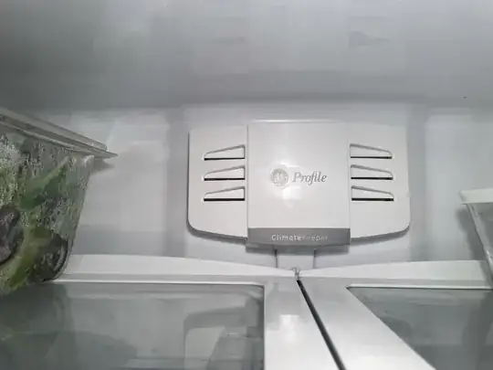

There is a small vent towards the top of the fridge in the back (labeled "climate keeper"), but I don't feel any airflow coming out of that. Is that supposed to have air coming out of it? Here's a picture of that upper vent:
Vent at top of fridge that doesn't seem to have air coming out

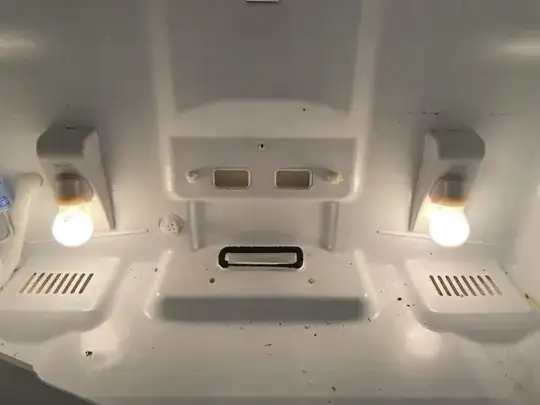

It's hard to tell where that would come from, though there is some sort of structure in the center behind the two bottom drawers that could possibly serve as an inlet for air to go up and out through the upper vents. Here's the center of the bottom of the fridge where the inlet could possibly be - there's a gap around it though no explicit openings: Place that could possibly be an inlet for the upper circulation vent?

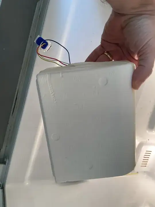

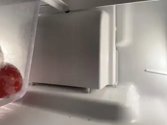

Update: So I took the other bottom drawer out and was able to unscrew the cover on the bottom housing. After taking it off, there was a styrofoam block there that seemed to direct air from a vent on the bottom (coming from the freezer?) to some holes in the back (that go up to the top shelf vent?). Interestingly, it also has a black device in it that has a smooth surface and is plugged in to a power jack. Not sure what that is, but it's not a fan. Here's a picture with the styrofoam block removed:
Bottom rear of fridge with housing and styrofoam block removed

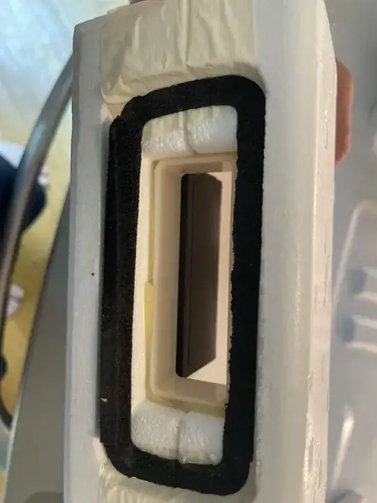

And a photo of the block and black device inside: Styrofoam block
View inside the styrofoam block
