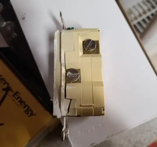

I removed the old outlet and found a small crack on the plastic, but the device seemed fine otherwise other than it's age. cracked outlet plastic

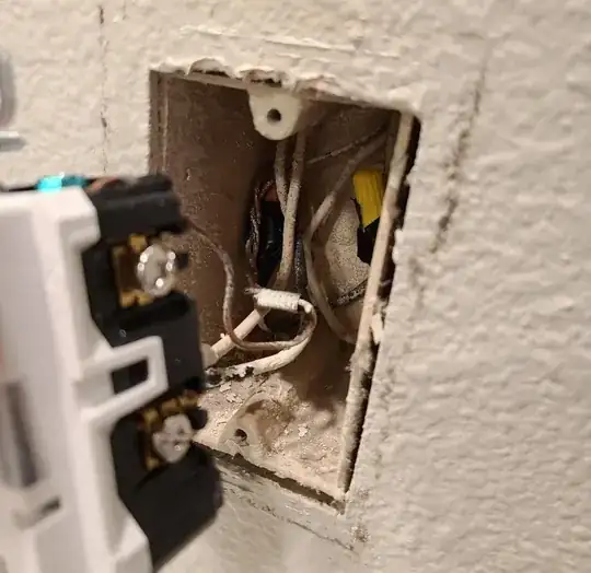

The box had only two 2-wire cables in it (yay). One was wired to "line" and other to "load" on the old outlet. Both ground wires were tied and wired to the outlet. I copied the old configuration and wired the new outlet and turned the breakers back on thinking I was done.
My outlet tester did not come on for either socket. I went through the troubleshooting steps on the new outlet and saw that the fault LED was white and the reset switch was not depressed. This indicated that the line and load were flipped according to the manual.
After some additional troubleshooting, I found that both my "line" and "load" wires were powered by different circuits. My non contact voltage tester indicated that the "load" black wire is hot when I turn on breaker #4 and "load" is hot when I turn on breaker #6.
WTF? This doesn't make any sense. Why would anyone do this? Also, breaker #6 has been a mystery and I have not yet figured out it's purpose to date.
Out of ideas, I wired the new outlet to breaker #4, capped and taped wires from breaker #6 and put the outlet back in to the box. I've turned off breaker #6 for now.

capped wires
