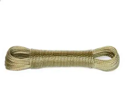

I have a clothesline that is made of 5-6 braided tiny steel wires that is coated with flexible plastic. I need to cut it to smaller segments, I tried using a cable cutter made of carbon steel but it barely worked and the wires kept fraying or wrapping around the blades but not getting cut.
The cutter itself is losing its edges despite being new and of decent quality, I believe it is made for electrical wires made of softer materials like copper and aluminum, not steel. I would like to avoid fraying because that can be painful if hands come in contact with them by mistake.
Here is a picture of the clothesline:

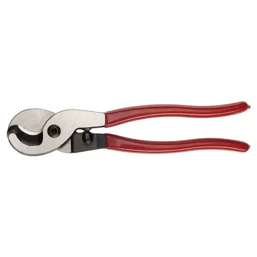

Cable cutters are the tool designed for cutting cable. If you're doing this a lot, the correct tool helps. For a one-off task, it may not be worth the cost, although then you have the tool for life.
Cable Cutters are basically scissors/tin snips but with curved blades, so the wire being cut is trapped and cannot squish out the mouth. I use something like this for trimming the braided wires on a bicycle's brakes.

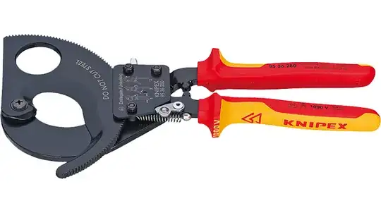

There are also fancy ones that use a ratchetting mechanism to cut beefier copper cables and wires. These would be for heavy duty mains wiring or automotive starter cable, and are far too big for this task. This one clearly says "not for steel" on the blade. You want the top one.

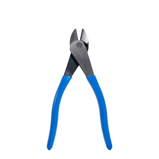

Cutting steel wire requires a hardened tool with a relatively blunt, durable edge. Diagonal cutters are the proper tool:
The manufacturer of the pictured tool describes their intended use:
Diagonal Cutters cut ACSR [aluminum conductor steel reinforced], screws, nails and most hardened wire

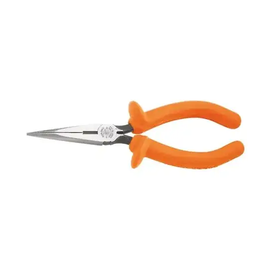

Many pliers have a cutting section near the hinge for this purpose, for example these long nose pliers:
Look around your toolbox, it's likely you already have such a tool.

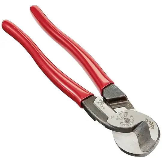

Bypass cutters, those that have two blades that pass by each other like scissors, are not designed to cut steel, though with a high quality tool and thin wire you might abuse them for that purpose. For example, Klein Tools makes these cutters which are not reccomended:
Notice the manufacturer says these cut copper and aluminum, which are substantially softer than steel:
Cable cutter cuts 4/0 aluminum, 2/0 soft copper, 100-pair 24 AWG communications cable
And if you look carefully at the tool, it says "NOT FOR STEEL" near the hinge.
The problem is the sharp blade is relatively thin compared to diagonal cutters, and so it will become nicked or bent with use until the blades no longer slide smoothly against each other. A quality tool will be hardened enough to tolerate this abuse for a little while. Cheap bypass cutters will be damaged on first use, if they manage to cut your wire at all.
