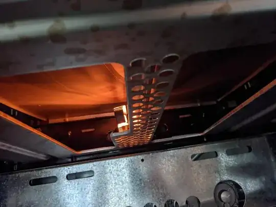

Oven before it starts heating (immediately after I set a temperature)
oven without flames The igniter is on but hasn't lit the flame yet

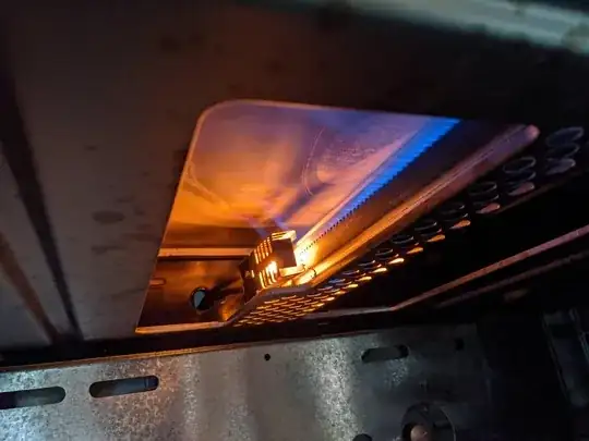

Oven when it's heating (10 seconds or so after I set a temperature)
oven with flames Now we're cooking with gas
