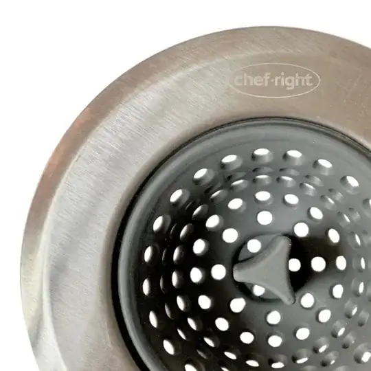

I would mainly be concerned with hair in a basement dump sink. If anyone using it has long hair I would strongly strongly suggest a basic drain filter. I bought a magnetic one that I thought was a PITA but it was actually so easy to use that I didn't mind dumping stuff out once a week or so into a trash.
closeup of a metal drain strainer with small holes and a plastic handle in the centre
That being said you cannot put large items down (chunked mud, pasta, potato). That is just a no and again why a strainer/filter will save you lots of headaches.

1. Get a strainer that works well with your sink. The amount of water and exit size will determine what you get. Don't make your sump pump a strainer... they are very bad at doing this.
