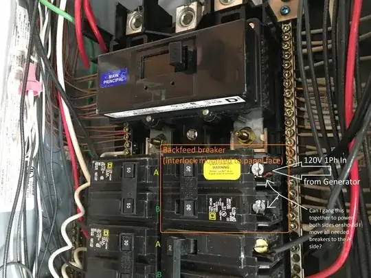

The result: I switch off the city power and bring up my generator system. Lots of stuff in the house works...except the circuits with GCFI outlets OR those on the few GFCI breakers that are installed.
From my reading, I believe my problem is that in my home, the neutral and ground are bonded (per code) inside the home breaker panel. Some of the current is bleeding into the home's ground system, being detected, and the GCFI's are doing what they're designed to do which is turn off.

Update - Found a clue, or maybe the whole issue! While looking at the wiring again I realized that I only powered one side of my backfeed breaker. My generator is 1ph 120v. The hot wire I put to the upper terminal so I realize now I'm only powering one side of the load center. Let's call it A since it's in the upper most position. All my unresponsive circuits are on the B side. I feel a little dumb now but I spotted that. Photo for clarity:Snapshot inside panel, with lables
So here's the question now...move my important breakers to the A side so they're all powered OR gang/bond the two terminals on the backfeed breaker. I think moving the breakers is probably safer long term.

While looking at the wiring again I realized that I only powered one side of my backfeed breaker. So here's the question now...move my important breakers to the A side so they're all powered OR gang/bond the two terminals on the backfeed breaker.
Depends. As the article you found stated, you must search the system for Multi-Wire Branch Circuits (MWBCs) aka shared neutral. If the wiring is done in cables, the red flag will be red wires on breakers. Investigate every red wire. If it goes to a 120/240V appliance like a range or dryer, that is not a MWBC.
If any MWBCs are present, you cannot split the 120V supply to feed both legs of the breaker. You can rearrange, but you must be careful not to mis-position any MWBCs. All of them need to have handle-ties anyway, and those will ensure correct phasing. (one hot on each phase).
If your panel has no MWBCs, feel free to split and power both hot legs.
