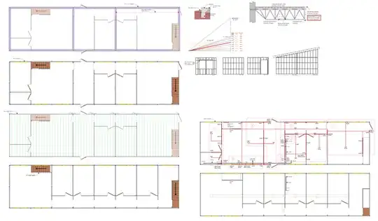

enter image description here I have been putting together plans for my dream house. First an architect friend of mine said she might help, but right now she's got too much business and she hasn't even had time to look at a drawing. Then lumber prices were sky high and someone suggested I use metal. So I redrew my draft plans with metal in mind, but I keep finding a lack of information. Like span tables. They exist for wood, but I can barely find the math for calculating maximum deflections in metal. As soon as I run into any questions, I'm left in the dark.
So I took this to an engineer in town and he said that wood construction is standard. There are fixed tables and placements that you just need to look up in the code. It's easy precisely because you don't have to do any math. Engineering a metal building is tough and the spacings, etc. used for wood won't work because the dead loads are much heavier. I might overengineer the building to support massive loads, at higher cost, but I can't prove it without the math.
An interested engineer could do the math and give me a set of drawings, but the county building inspector won't know how to read them or what to do if we have to deviate in the least. I would have to take them to the state's steel engineering expert, along with the math, to get his approval. If I change anything, we are literally back to the drawing board.
I've started looking back at my wood drawings, but even then I wanted a steel beam to go over the 20' span in the kitchen and great room. I would definitely need 2x12x20s across those expanses and not all species of wood would be strong enough. Everywhere else, I could get by with 10' spans following the length of the house.
Now that I've looked at it, I'm actually more interested in steel and especially in its anti-rot, anti-bug, anti-water capabilities. Is this all completely hopeless or is there a way to finish the construction in steel? Where do I go to get the right kind of architect or engineer?

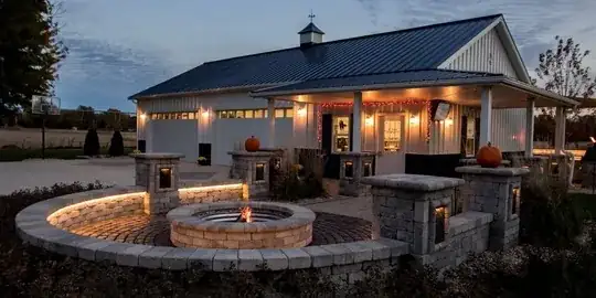

There are loads of pre-designed steel building shells out there. Use one.
These are offered by commercial building companies for farm and industrial buildings. They have gotten a family of designs pre-approved, and they pre-manufacture all the required beam sections. You take one of their stock widths, and any length you want as long as it's a multiple of X feet. They can get pretty sophisticated, but all the engineering is pre-computed and pre-approved.
As long as you don't mess with the structural envelope, you can do anything you want inside it.

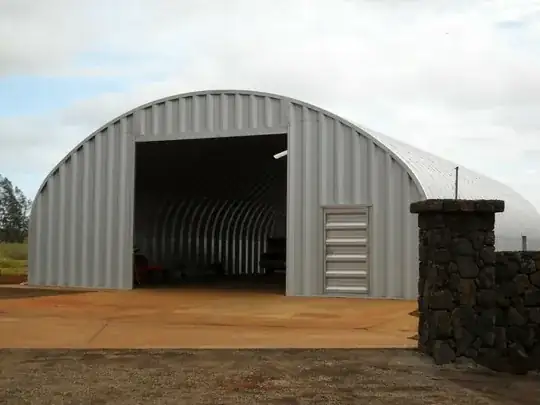

Prefab metal shed.
prefab shed
These are popular and durable. They are used on farms and workyards everywhere. Many, many sizes and shapes are available. Quonset huts many decades old are still in service. If you want a metal building why not buy one from a company that makes and sells them. There will be people from the company available to help you put it up. There will be a standard way to assemble them. Then you can concentrate on creative aspects and not worry if the pieces you used are robust enough to do what you are asking of them.
Hopefully you don't have a neighborhood association.

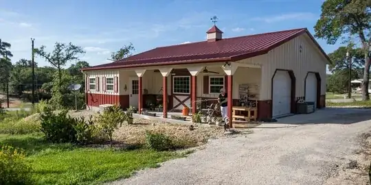

It absolutely can be done! I don’t have the expertise, but my father did. He had a mechanical engineering degree and worked in construction of commercial buildings until he was able to begin his own construction company building metal buildings….. notably homes. I grew up filling screw holes and taping and bedding those CFS studded walls.
My father and step mother built their house with only themselves and family…. It took a long time and it has a combination of giant red steel I beams and CFS as the structure. I’ve always been proud of their house knowing we all had a hand in building it and it’s far more durable than the wooden houses that are mass produced around me.
Just wish he was still around to ask. Don’t give up. It can be done.
