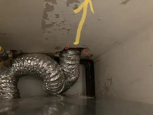

This is 3rd floor condominium,
Dryer vent goes up and opens on the roof.
There is around 4 to 5" extra space around dryer vent in my wall, my neighbor reported rat in their house. I want to seal this space and make it rat proof.
My questions.
  1. what can I use to cover extra space ? Drywall patch ?
  2. to make it rat proof, I can stuff it with steel wool but there is going to be lot of cavity inside wall, how can I ensure that Steel wool is packed and dense around the opening and not loose because of lot of space inside wall.
Duct goes up towards roof (yellow arrow) Red arrows shows space I want to seal so rats can’t come in.

I would adhere (probably caulk (rather than an epoxy, or some such) to allow it be removed more easily, at a later time) a tight fitting (around the duct) piece of sheet metal (or Al or something metal and thin) to the ceiling. I would then caulk around the duct and edges (to minimize traveling "smells" that attract rodents). You could also use use inserts and screws to fasten the sheet metal to the ceiling.
In my experience, steel wool is good when the hole's small or has a backer to limit the amount steel wool volume needed. (I'd also caulk over it.) Another tip - use "copper wool" when there's a chance of the steel wool rusting and staining the surroundings.
