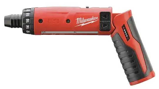

There are on the market power screwdriver that accommodate both styles of holding the tool. They switch from L-shape to I-shape.
power screwdriver that changes from I-shape to L-shape
The more serious drill/drivers seem to be made in just the L-shape format. They cannot be held like a pen-screwdriver.

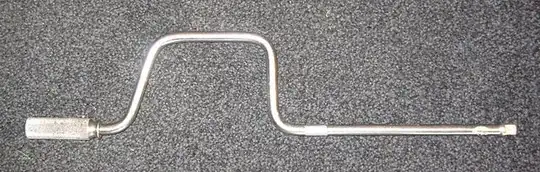

This is what I use: A speed wrench and a bit holder. You can press as hard as needed, you get crazy leverage, and it doesn't wear out your wrists. Tremendous torque and you can stop on a dime.
Also, it lets me hold the drill back for use as a drill for pre-drilling holes.
