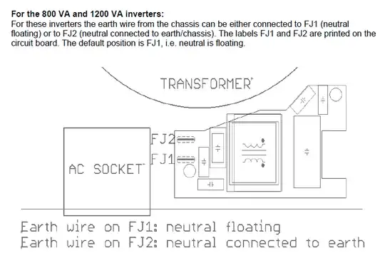

I am working on installing a Victron Energy Phoenix Inverter 800VA into my little teardrop RV. I am doing something men just don't do, I read the Victron Energy Phoenix Inverter manual! Appendix A starts off by saying:
The AC output is isolated from the DC input and the chassis. Local regulations may require a true neutral. In this case, one of the AC output wires must be connected to the chassis, and the chassis must be connected to a reliable ground. Inside the inverter, a provision has been made to be able to connect the neural and the chassis; the way to do this is explained below.
Please be sure to disconnect the battery when connecting the neutral to protective earth (PE).
An internal PE wire, which is used to connect the neutral and the chassis, is accessible after removing the plastic cover. A Torx T10 screwdriver is needed to loosen the four screws which hold the plastic cover.
And it concludes with this:
For both safety and functionality, I am seeking two answers:
1: It sounds to me like the neutral is floating right now. Do I need to open up the case and move the wire?

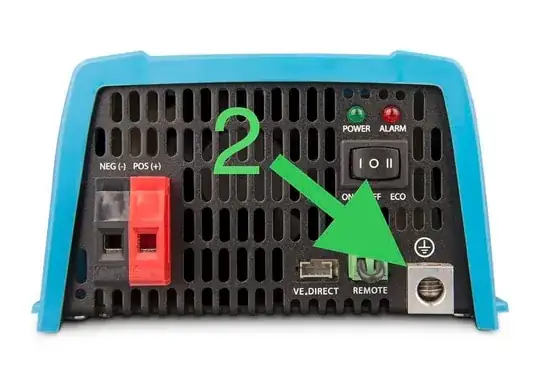

2: Regarding the ground on the inverter (seen in the next image), should I be connecting that to the chassis of the RV?

TLDR: Do bond the inverter. Use a "generator interlock" or other DPDT switch that switches both hot and neutral between shore power and inverter. That "switch" could consist of an outlet (fed from the inverter) right next to the RV's inlet. To run on inverter simply use a 1' extension cord to jumper the outlet to the inlet.
What you don't want is TWO neutral-ground bonds in the system.
I believe we already discussed the "how to" of isolating neutral and ground when you are on shore power. It requires a large, annoying, and hard-to-fit interlock (or at the least a UL listed 30A DPDT switch, hard to find in a small form factor). The rest of this section describes the "why" - feel free to skip it if you're a believer lol.
The first problem is accidentally being THE neutral-ground bond for the whole neighborhood. The house is supposed to have its own neutral-ground bond for fault current. Suppose the house bond fails. Consider this scenario:
Suddenly, due to an internal short, the house's range is shunting 2000A from hot to ground. What's supposed to happen is it flows the 2000A via the house's neutral-ground bond to the neutral, back to the transformer, resulting in massive current flow and instant trip of the 50A breaker.
However, with the house's bond broken, the only neutral-ground path is onboard your RV. So all the range's fault current goes out ground on your 30A extension cord, to your chassis, through that FJ2 connection on the Victron, back to the panel and out the RV's neutral wire. And because of the very long wire run, only 80A flows. That could take 30 minutes to trip a 50A range breaker*. Remember all this current is moving on neutral and ground, which don't have fuses.
You could have the same problem if a neighbor's house has a working neutral-ground bond, *but has lost neutral from the utility's service drop (we field a question about that at least once a month)... so it is routing all neutral current through the dirt, to other houses and other people's neutral-ground bonds. This is not even your current, yet your redundant bond is forced to handle it because your house's bond is inop.
Ed Beal discusses another double-bonding failure mode: you plug in shore power from a site with an inoperative ground wire, and then, have a ground fault on the RV. Now, the RV chassis is energized!
I hope I haven't beaten that dead horse too much.
Do you have to bond this? Pick your poison.
The simple answer is to have your utility/inverter interlock switch neutral, i.e. since it's a 120V RV, you need a 30A DPDT switch. But I know in our earlier discussion, I tried ways to build this out of Home Depot tier electrical gear, and that was bulky, and you were already committed to a bulky "all-in-one" battery charger which was not designed for use with an inverter. There wasn't room for two bulky things.
So to sustain the simple answer, there are 2 options: go industrial-tier and find a compact, UL listed DPDT switch... or simply wire the inverter's output to an outlet right next to your RV's inlet, and install a 1' jumper cord between them, so the RV is literally plugged into either shore power or inverter.
However, if that is not an option, then pick your poison: Jumper and risk the above scenario, or DON'T jumper and then, in inverter mode, you have an "isolated system". Normally, we don't like those, for reasons.

Grounding the neutral creates a parallel path for return , or in some cases with the neutral connected to the PE it is possible for some one standing on the earth or touching a metal fence and the trailer to get a shock because of the parallel path. I am not sure of the wiring but your inverter may only connect the ground to neutral when on battery or actually producing a separately derived voltage (code speak).
