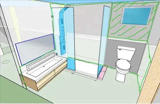

I have this layout and all the areas marked with green will get tiles I am not sure about the area around the window (marled with diagonal green lines)
The area I have doubts about is the area above the green line at the bottom of the mirror. I have cement boards that would cover that entire wall (2 sheets less than 8' long)
From what I am reading the cement board could be painted over, or more accurate said, certain types of cement board
What would you recommend me to do in this case ? Should I transition to drywall in that area behind the mirror ?enter image description here

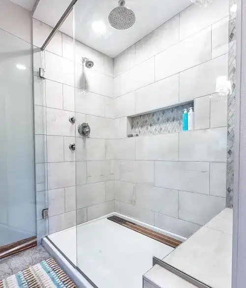

Notice how the tile goes past the glass door.
If you did cement board the entire bathroom then you could apply drywall on top of it and end up fairly flush with the tilework. You will of course have to use cement board screws to attach the drywall so things could get expensive. You'll still want to extend the tilework beyond the tub-shower for the aforementioned reasons.
