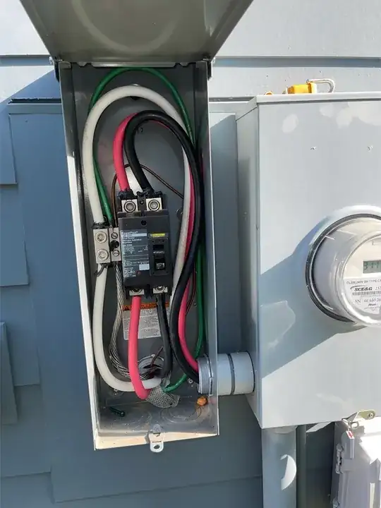

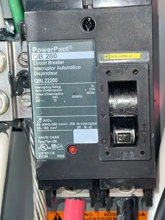

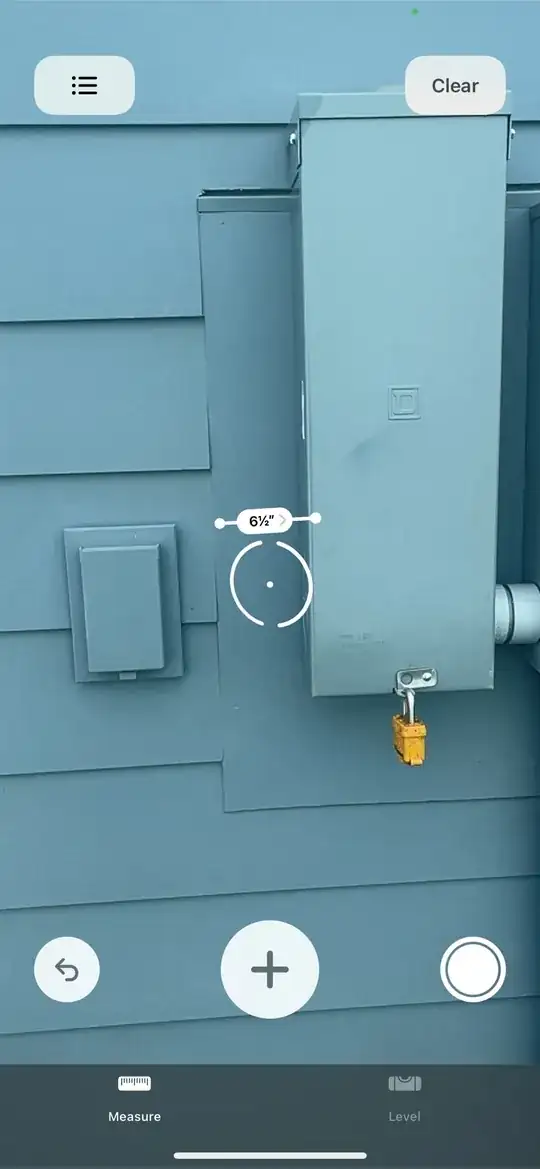

Except I looked and that's not what we have on our own home. We don’t have a meter but up against a small box that there’s no room for anything other than the main breaker. We have this:
main shutoff main breaker SquareDbox enter image description hereenter image description here

The question is different but the answer is exactly the same. This breaker does not provide any location to attach the wires from the SPD.
The only difference is this is a discrete main breaker, not a meter-main, so it will be a great deal easier exchanging this unit for one that does what you want.
That being a main-breaker service panel with thru lugs (but without the meter pan).
The power company need only pull (or remote disconnect) the meter, no need for a bucket truck.

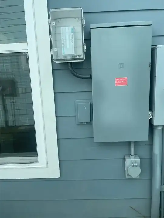

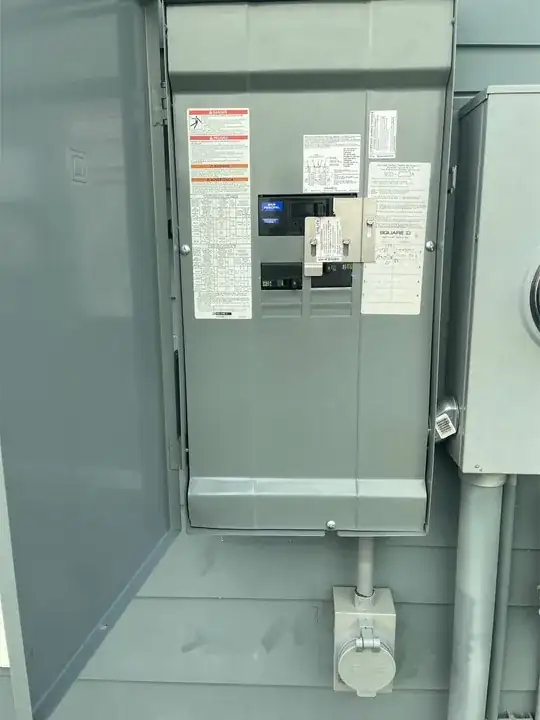

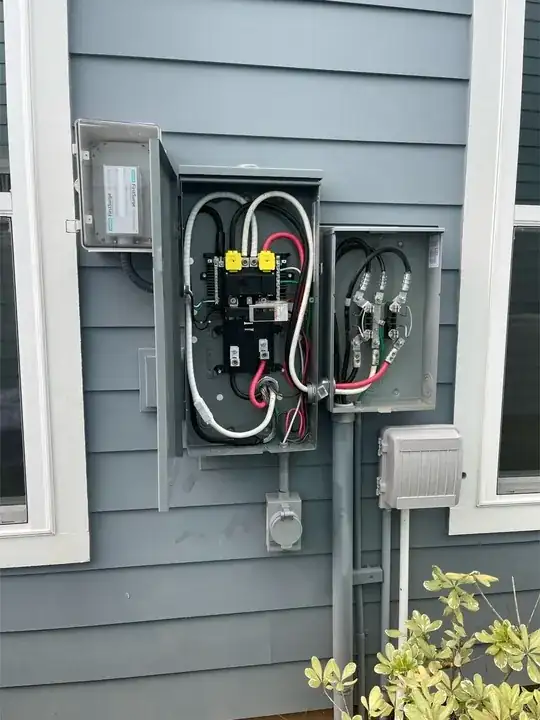

Done. Main shutoff plus Generator input with interlock plus Whole house SPD. First Surge is rated Nema 3 I think, but even instructions say if weather an issue, to enclose. So the clear box is nema 4
