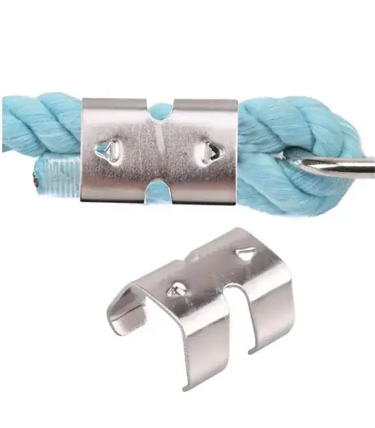

What I’m wondering is if anyone knows of a good diy method for securing rope to the eye bolts? Tying will be difficult because the rope is so think but could be done if I have no other options. In reality I’d like to get a rope clamp like the one pictured below for each tie but they go for about $10 a pop for the ones large enough to secure a 3/4 rope. Since I have about 25 points to secure I’d prefer to avoid dropping that kind of money.
Is anyone aware of any way to make my own rope clamps for cheaper using rubber coated wire or anything else? Is there a clever way to secure these ropes that I’m just not aware of?
$10 clamp: enter image description here

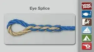

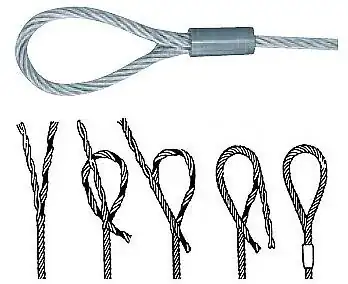

With wire rope one can weave a flemish splice like this:
flemish splice
I don't know whether that's possible with other (non-wire) kinds of rope though. Maybe an eye splice, then?
eye splice
Either of these could be finished by covering it with some heat-shrink tube.

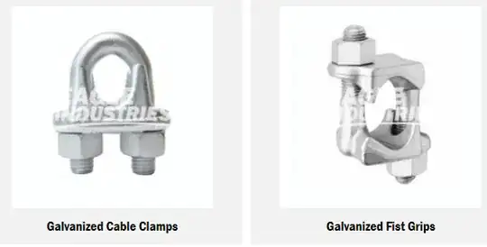

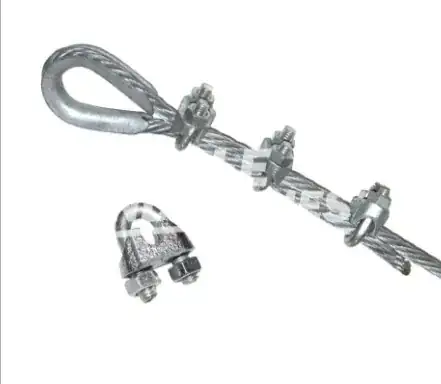

Rope Clamp
https://www.eagleind.com/accessories/
https://www.grainger.com/search/material-handling/lifting-pulling-positioning/wire-rope-and-fittings/wire-rope-clips?ts_optout=true&searchQuery=rope+clamp&categoryIndex=1
Please make sure you get/ask the maximum grip capacity and set a safety factor of 2 to 4. Safe working load = Capacity/Safety Factor.
