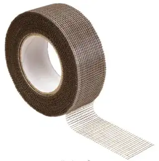

The correct way to "mud the joints" is going to be to use tile thinset and a fiberglass tape made for cement board. It's similar to the sticky fiberglass tape made for drywall, but its thicker and more abrasion resistant since the thinset has sand in it and can be vary abrasive.
cement board tape
Sample listing, but sold at most places that sell the cement board:
Cement board tape at Home Depot
