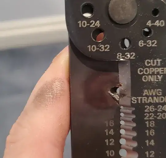

I started with the smoke detector I'd used the voltage detector on. I unplugged the old smoke detector and checked to make sure the new smoke detector fit. I discovered that the new detector wouldn't fit because it has a bulge that would need to stick up into the junction box, but there was no way to make it fit because the wires in the box were so long (roughly 8 inches from the ceiling + wire nuts and another 2 inches to the AC connector) that they filled up the whole box. I decided to trim the wires back a few inches.
I grabbed my wire tool and cut the red interconnect wire first. Then I did something which in retrospect was very stupid: I cut the hot and neutral wires at the same time, thinking I was safe because the circuit was definitely off.
As soon as the cutter made it through the rubber insulation, it bridged the connection between hot and neutral and EXPLODED. A huge shower of sparks burst from the wires and I fell off the ladder screaming. By some miracle, I escaped unharmed and the sparks didn't set anything on fire.
I'm guessing the only reason I'm not in the hospital or dead right now is because I was on a fiberglass ladder and the wire tool has an insulated rubber handle. You can see here where the arc burned through the metal and lightly singed my finger.
The arc burned a hole in the metal and singed my finger.

After writing out the question, I realized I had forgotten to check something. I went back to the panel to see if any other breakers besides the dryer circuit had flipped off, and sure enough, the "garage light" breaker had been tripped. After testing more, I determined that the smoke detectors are actually on the "garage light" circuit breaker, not the "dryer" circuit breaker.
So apparently in all of my going back and forth to the panel and testing different breakers, I somehow confused myself on which circuit the smoke detectors were on. False positives from my NCVD may have initially prevented me from realizing when I did have the correct breaker shut off, and definitely caused me further confusion after the initial accident.

Could be an unmarked Multi-Wire Branch Circuit
We often look at people's panels for other reasons, and we often say "hey, see the red+black wires from the same cable, going to 2 independent breakers? Those need a handle-tie. So when you shut one off for maintenance, they both shut off". And people say "thanks" but think "why bother?"
Well, this. This is why.
A Multi-wire branch circuit (MWBC) is where 2 hot wires share the same neutral. (or 3 in 3-phase wiring). This works because they are on different phases -- neutral carries only difference current - if one leg is drawing 16A and the other 15A, neutral carries 1A, not 31A. (use of a handle-tie also helps enforce phase placement).
These don't require common trip for safety, so they don't need to be on a 2-pole (3-pole) circuit breaker. But they should be handle-tied so maintainers are forced to shut off the entire circuit.
The procedure you did - turning off breakers until "hot" current goes away - is normal and common. However, if a MWBC's two hot breakers are not handle-tied, then the other half (2/3) of the circuit is still hot! And there is current flow on neutral! If you short another hot to neutral or ground, kaboom! Or if you interrupt neutral as part of maintenance, you have series arcing when it parts, and the "downline end" of the neutral now has 120V on it. (the downline loads on the other phase are trying to return current there).
So that certainly could have caused what you describe. The cure is to search the panel for "shared neutral" situations (if wired in cable, the sure sign is a red wire on a 120V breaker) and make sure to fit those handle ties!
