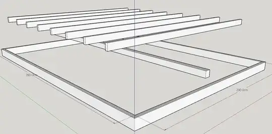

Option 1:
Option1
Pros
  • Overall height is short enough that I can easily put the frame and the planks on them in my 15cm of skirts.
Cons
  • I'm afraid it will be too weak.

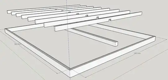

Option 3:
Option2

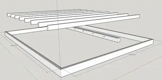

Option 4:
Option3

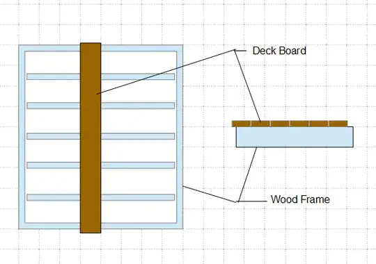

How about adding an option (5).
The thinking is to evenly distribute the floor load to the edge beams, so the edge beams will be stressed less and deflect less than a concentrated load from the center joist. Since it is now stiffer and the space between joists is much smaller for the deck board to bridge over, the board can be thinner, and directly nailed to the joists instead of needing other hardware. My answer only provides the concept, as for the size of the lumbers and spacing of the joist, a structural engineer shall be consulted.
