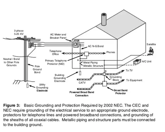

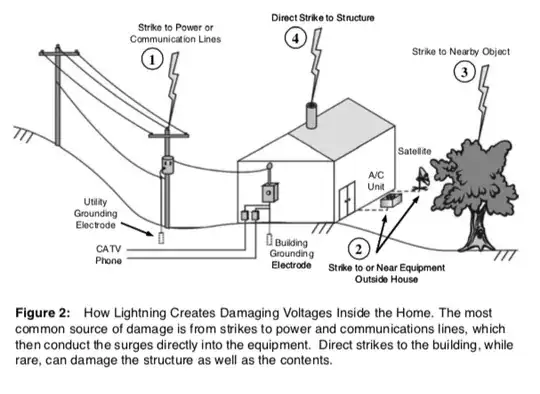

What NEC/CEC, IEEE and ARRL say...
Most buildings now have many additional outside connections—exterior lighting, remote gate controls and security monitors, electronic dog fences, auxiliary buildings, etc., which are often not dealt with in the codes. Any of these connections can bring damaging lightning currents into the building.
Finally, and most significant for many people, modern houses have from $5,000 to, in rare cases, $500,000 of electrical/electronic equipment, such as in utility systems, home entertainment systems, computers, security systems, and building automation systems. All of these are extremely vulnerable to lightning surges brought in on power or signal cables, and the basic NEC/CEC requirements do little to protect them.
Ref: How to Protect Your House and Its Contents from Lightning, IEEE Guide for Surge Protection of Equipment Connected to AC Power and Communication Circuits, Published by Standards Information Network, IEEE Press

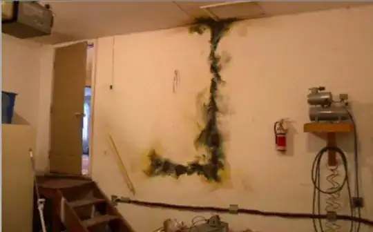

And if you don't:
Source: Lightning and the Radio Amateur, Glenn R. Cate N4GRC
