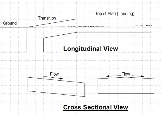

We're building a wheelchair ramp, the bottom is to be a concrete landing slab. We are in the northeast US, so we get snow & ice (though the ramp likely would not be in use during the dead of winter - This is for a childrens summer camp).
I was going to build the wooden form such that the top of the slab rests around 1/2 - 1" above the surrounding grade. The thinking being to basically keep water, mud, etc off it - "Self cleaning" of sorts
But I presented this to my partner, his thought was that it should be BELOW grade 1/2" or thereabouts. This would protect it from being hammered by a potential snowplow incident (very valid concern) and he some other reasons which I'm unfortunately blanking on....
What say ye?

IMO, the most important feature of this slab is the transition to the ground level, which makes the slab fully wheelchair accessible. To avoid hitting by the snowplow, you can add a warning barrier, or make a strip of flower bed alongside the slab.
Place an adequate layer of coarse gravel, which shall be compacted to offer good bearing capacity, and deep enough to avoid damage by frost heave.

Above and with a slight slope so that it doesn't collect water.

Or 1/2" below, with a slope and a drainage channel with gravel or similar.
