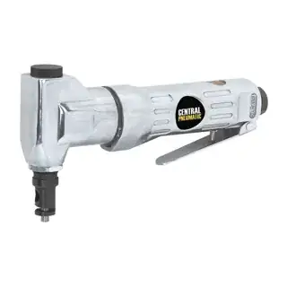

Cutting curves in sheetmetal is a good job for a pneumatic nibbler. They can cut strait lines or curves with any radius and can be a little cleaner than a jigsaw because they support both sides of the material while punching out little bites.
air nibbler
If you don't have a decent air compressor, then they also have electric versions and even drill attachments that do the same thing. They can only cut sheet metal, so if you have to cut through a support or reenforcement, you will have to resort to a different tool for that. There is a learning curve to using these, so start with a smaller diameter hole to practice then move up to the actual hole you want.

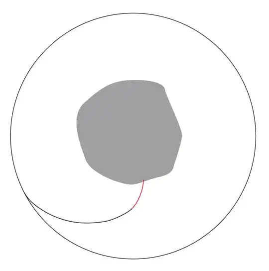

From there, I would use hand tools, such as a VERY fine tooth hacksaw, working carefully. Start it by drilling a hole well inboard of the edge. Either use the kind of hacksaw where part of the blade extends beyond the tool (and don't kink it).... or, cut a 4" diameter hole in the middle using coarser methods, cut the first inch with the bare blade (wear gloves, I show this in red) and then put the bow of the hacksaw through that hole. 12" is a large enough diameter that a hacksaw can make that curve. You'll have 45-ish lineal inches to cut, but that's not so far in such thin metal.

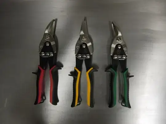

Aviation Tin Snips are also an option, however being manually powered they're a lot of effort.
If you're right-handed then you probably want the red-coloured ones, because they turn to the left as you cut. Left-handed users would want the green-handled ones in this instance.
Downsides are that you need a fairly large entrance hole, and like in @harper's answer you need to spiral into the final cut, which will make your cutout piece less-useful.
Three tin snips
